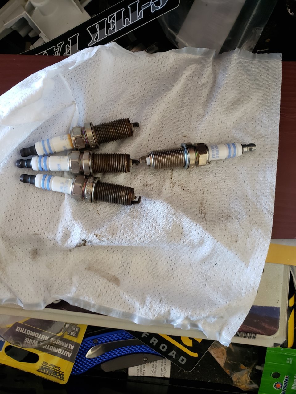

    Recommend 30k an dont use gas from a sketchy place. Did mine today an also cleaned maf an throttlebody.
    I been using sketchy gas not anymore.

    Holy smokes!!! that's 30K? The jeep plugs looked like that bottom left but not even that little nib was left. My original Denso /NGK oe plugs were nowhere near that bad.
