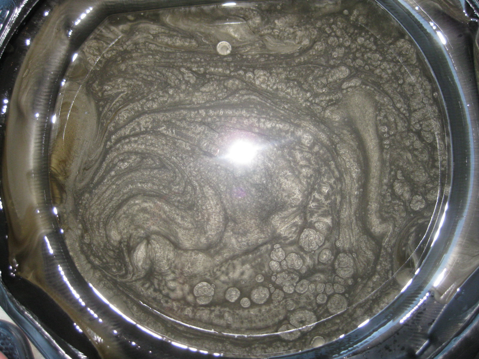

    Remembers its the Toyota Engineers who recommend changing the rear diff lube at something like 30 or 60 thousand miles. This is what it looks like at 3000. You are more than welcome to believe the smarter engineers and leave that wear metal eating away at bearings and seals... I am not.

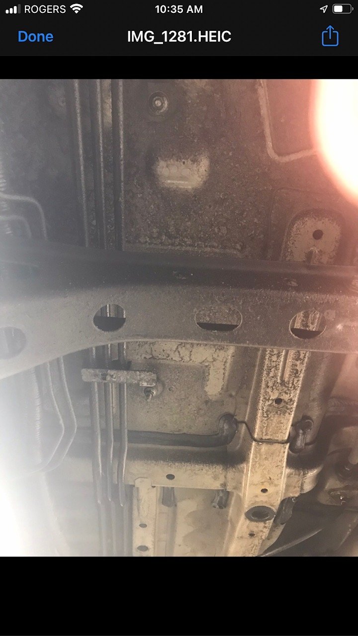

    To be fair, rusted out frames really is due to people driving around on salted slush roads and not rinsing off and caring for their frame afterwards. Toyota's don't have a single problem with rust down here in the south where we don't salt our roads. Toyota was nice enough to take care of these people when any vehicle subjected to those conditions would rust.

    And Dana who made the frames paid 25 million to Toyota to settle the frame issue.
    Sounds like it was more than just a user issue if the manufacturer of the frames is paying out???

    Living in Toronto I know to well the effect of salt on every part of a car and we both agree on that. I have mine Krown oil sprayed every year and after 8 years the frame is in terrific shape..
    The issue was not that the early frames rusted (they all will). Its that they rusted out prematurely and the quality and treatment of the frames from Dana was the issue.
    If there was no manufacturing issue with the frames Dana wouldn't have paid out a cent
    Greasy side after 7 Toronto winters and regular krown oil sprays

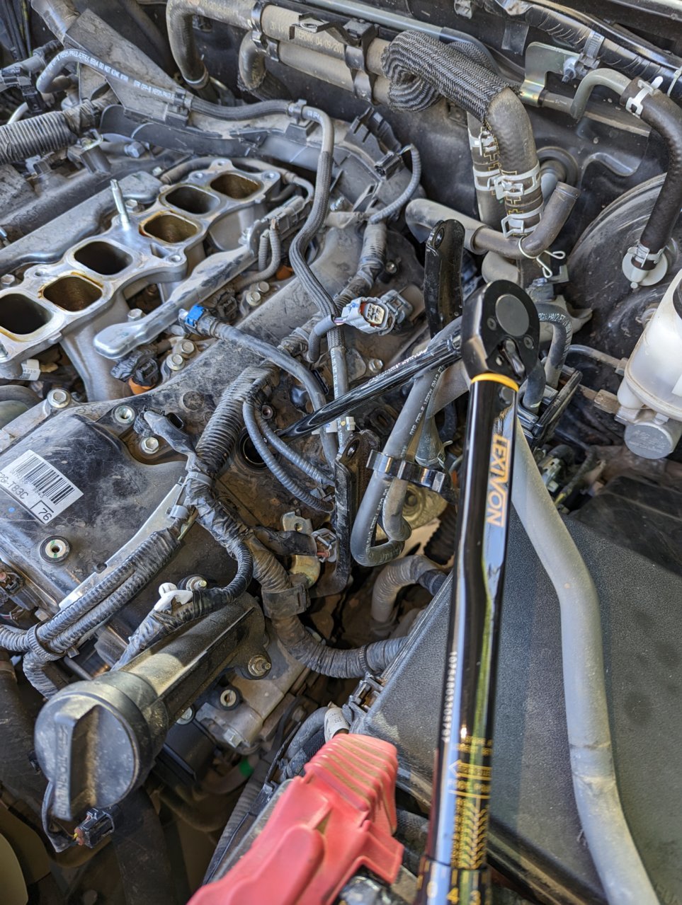

    Its recommended to pull the intake for the 3rd gen as well. Some people say you can change without pulling the top. I found that pulling the top was easier than having to work around it. And then I had to walk to the hardware store when I realized my socket extensions wouldn't reach the bottomless pits they buried the dang plugs in. :anonymous:

    Having a magnetic socket is definitely something I would recommend over the rubber style retainer. If you drop the plug into the plug hole, you will bend the electrode, that's a long drop!!!
    I just happen to have a Snap-On socket from working on Natural Gas engines. Milwaukee also just released a magnetic sparkplug socket too.
    As @Rock Lobster mentioned removing the intake makes removing the driver's side plugs much easier to get to. You could reuse the gasket but it was cheap enough at the dealership, I just replaced it.
