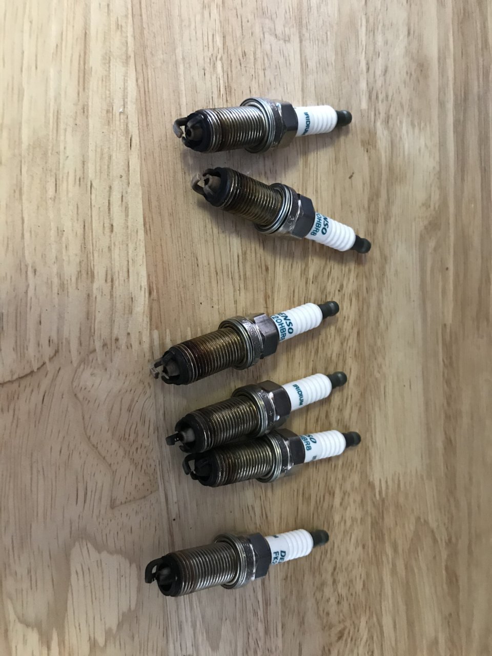

Spark plug change is this normal?

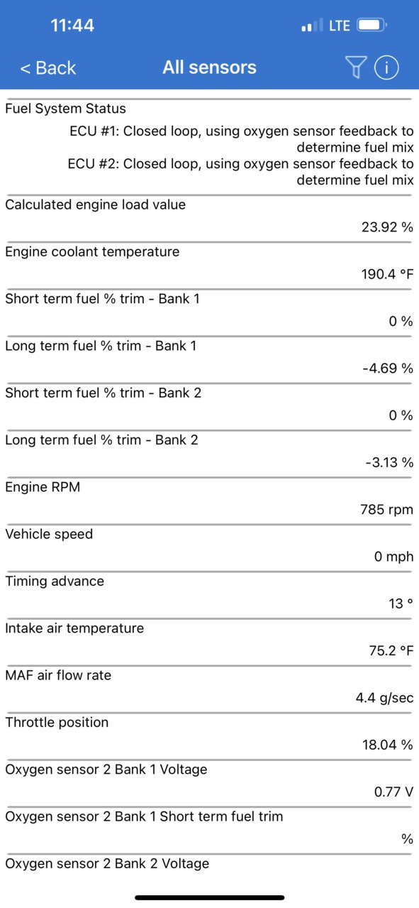

    IMG_3601.jpg How’s all this look for you mechanics on here? This is after a quick 5 minute drive and now sitting at idle in the driveway

    Healthy...

    Looks good to me
    Take another screen shot cruising up a modest hill
