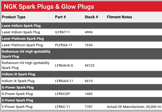

    With the V6 4.0, it's a great debate. Some do, some stretch it out, and some wait until the vehicle starts missing and wonder why. Some stick with stock and some will use iridium. Some claim to have issues with anything other than stock plugs.
    Here's what NGK states will work in a V6, 4.0. The stock NGK plug is at the bottom. Denso has something similar on their website.
