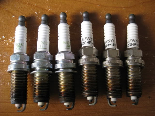

    The top set are Denso plugs and the bottom are NGK. The Denso's gap was between .043 to .045 whereas the NGK's looked a little more worn. They were between .047 to .055. Notice the dark what looks like oil on the threads. Is this normal? My mileage and everything seems normal. I typically get between 17 to 18 mpg (4X4). Also about what mileage do any of you use Seafoam?

    They look just fine. As usual these days, our vehicles run pretty lean, so they're quite light colored, but they're all the same. No problems that I see. The gaps will likely be wider than they should be only because there's 30,000 miles on them. Good to go, man. Put in some fresh ones and truck on.....

    Yeah, I just think it's funny that Toyota used Denso on one side and NGK on the other. It looks like the Denso's held up better. The gaps didn't wear like the NGKs did.:rolleyes:

    Looking normal. changed out mine at 60 k. the spark plugs closest to the firewall action of fair amount of oxidation and fouling. yours look great

    I just changed my spark plugs as well and also had results similar to the OP.
    OP did you note the location of the plugs (forward or aft end of block)?
    The plug with most residue on the threads was the NGK on the driver side closest to the firewall. I'm curious if that side naturally gets the most blowby gasses fed to it's cylinder.

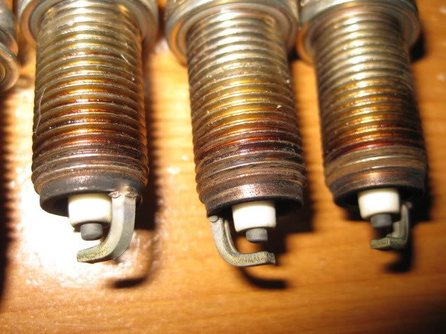

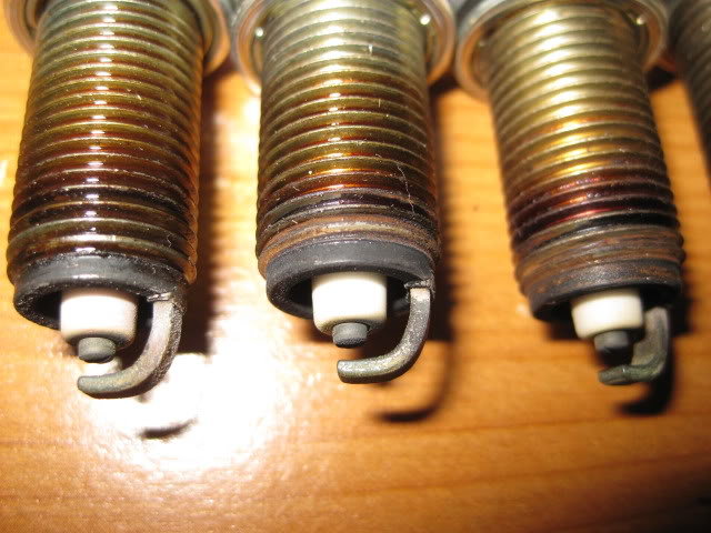

    Anyhow, these are the pics I snapped when changing the plugs:
    And not to cause any unjust worry, but I originally used a rotary type gauge to gap the plugs but measured it with my calipers after and found it to be up to .005" (5 thousandths) too large. So I used a feeler gauge to regap them. So if anyone recently changed plugs and gapped using a rotary type gauge, measure the thickness with a caliper if you got it.
    No, I did'nt think about that till it was too late. I did find it interesting how the NGKs wore more than the Densos. I look forward to seeing how these do this time around.

    I did mine not too long ago, and also found the driver's closest to firewall was the dirtiest. It worried me a for a little while, but then read someone here mention the same thing a couple times, so it sounds normal.

    I posted these pics on 9-28-11 with my 30,000 mile report:
    Here are the NGKs:
    Here are the Densos:
    I was disappointed that the new plugs did not improve the gas mileage at all... ie. no change.
