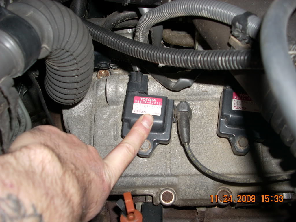

    Ok first pic is of my finger on the coil pack.........notice the wire to the right......that is the spark plug wire to the spark plug on the other side. Follow it to the plug. Also the side with the coilpacks the spark plug is underneath the coil............undo the bolt in the pic pull straight out, look in hole you"ll see the spark plug.

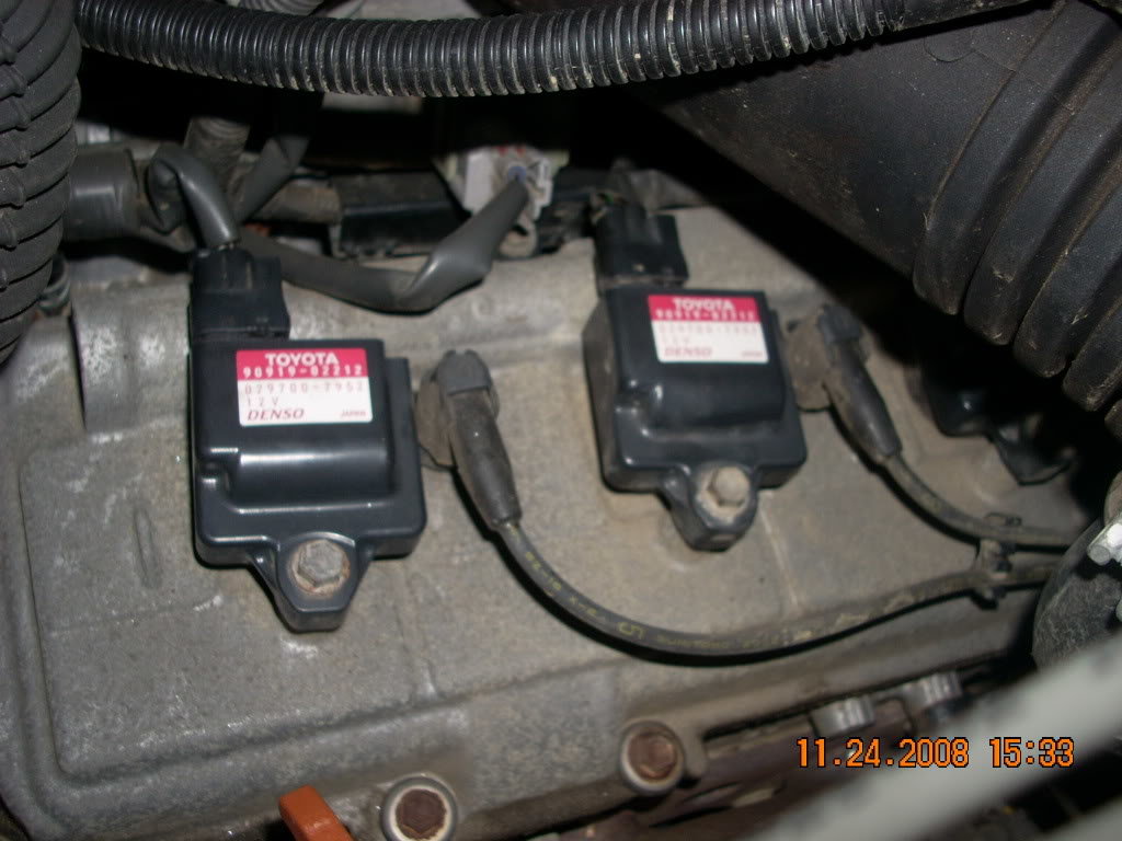

    Next pic is of two coilpacks .
    On the 2009 Model you might have 3 coilpacks or six not sure. Just look for the coilpacks and any sparkplug wire running away from it.

    the first pic is my hot truck,
    2nd pic should be the drive side of the engine and 3rd pic is driver's side engine... u mean the coil pack is that black knob on that engine block? sure looks a lot different than the 02 :confused:

    Yup thats them..........undo the one bolt that secures it down and pull it straight out and you will find the plug in the hole.

    The coil pack is on the valve cover, not the block. It has the wires going into it.

    Chris is right should have pointed that out also.........sorry I forgot you don't know what to look for.
    The last pic of the two black square things with the wire connected to it and one bolt attaching it to the vavle cover are your coil packs.
