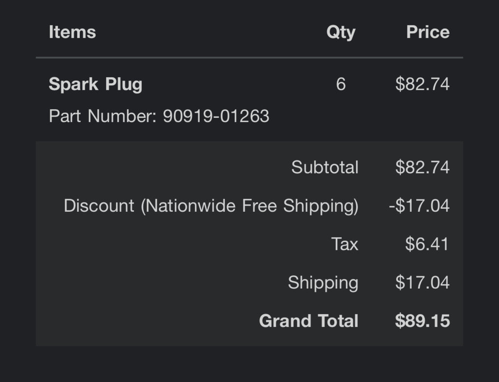

    I just ordered for 89 shipped from the Toyota dealer (ca tax)- check the website for various ones because some run 30% off vs 20 when there is a sale. If you’re in Hawaii I’d offer to order and send it to you for 100 but I’m not sure if just walking into Servco would be cheaper at that point.

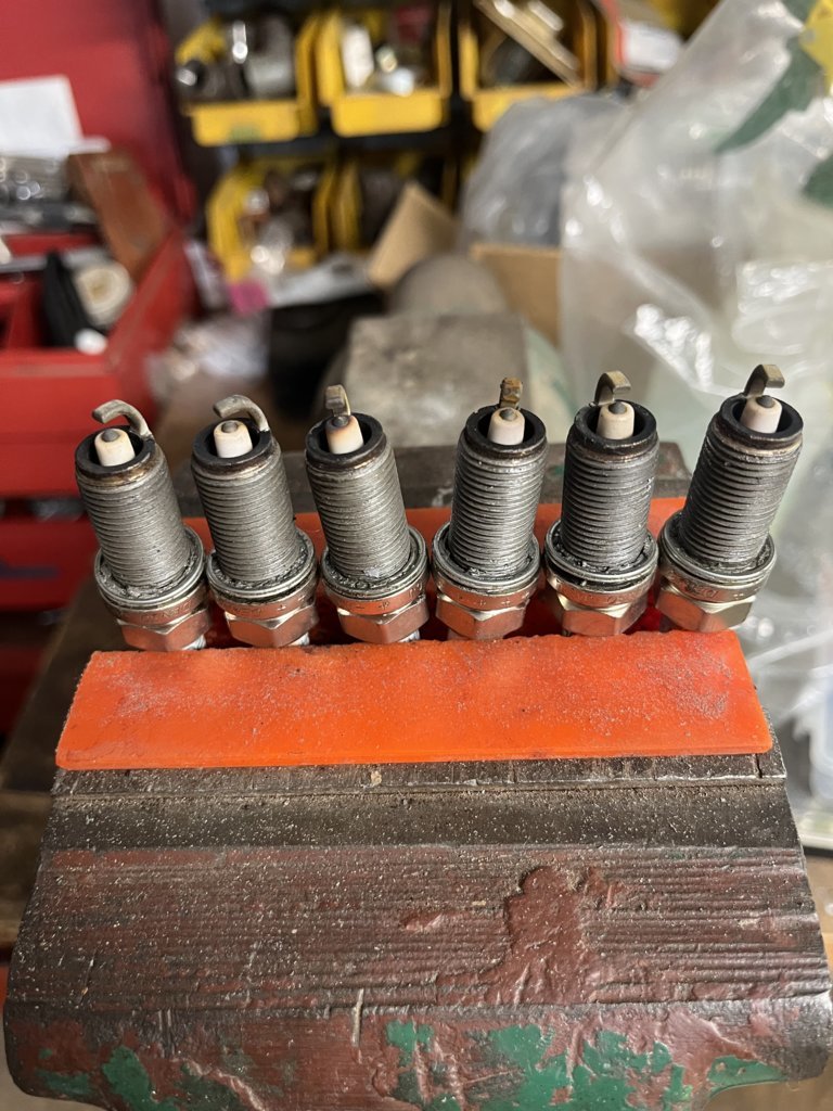

    If you’ve got a 10mm and a 12mm socket and a couple long extensions, it will take you an hour to change them.
    Be aware, if your truck didn’t come with iridium plugs, stick with the DENSO copper V groove plugs. They’re $6 each at the dealer and last 30k. If you decide that you’re going to go to iridium’s so you only change plugs again after 100k, see my picture below of what a 4.0 will do to a DENSO Iridium after just 20,250 miles…. TOAST! $65 worth of plugs right in the trash!
