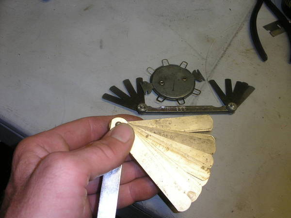

    The picture doesn't do it justice, but if you look you can see measurements on the "BLADES" I got really good at this on my previous vehicle and all the valve adjustments I had to do(Aircooled VW) just stack,,,,well, if you don't know just let me know..it's really easy a kind of do it yourself job
