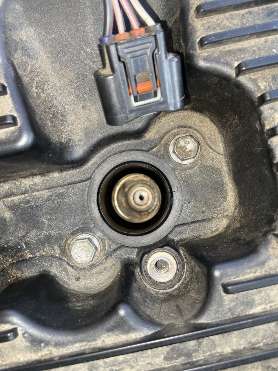

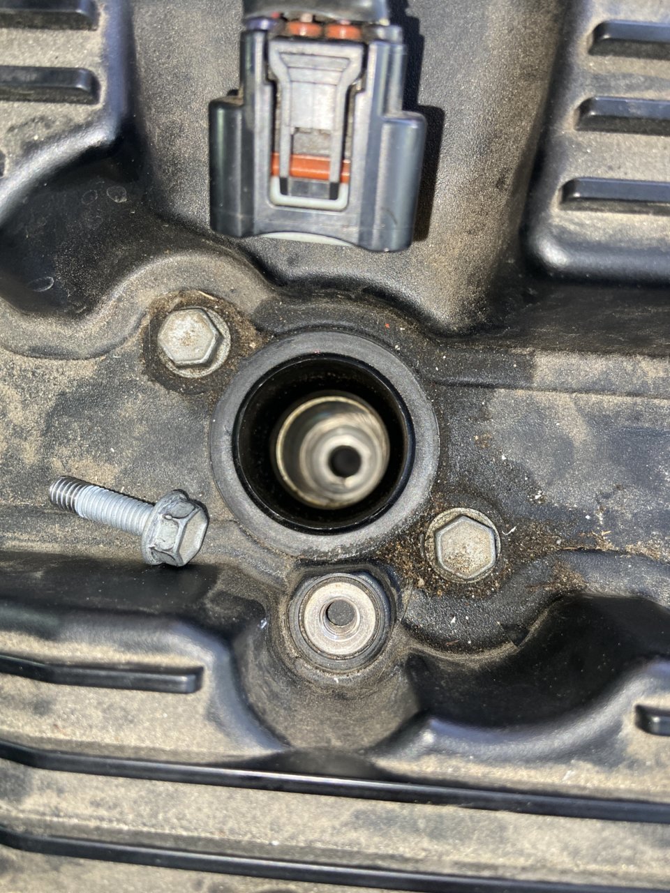

    This is my 2015 Toyota Tacoma 2.7 L four-cylinder I had taken out my spark plugs in order to do a compression test. As I was putting back spark plug 1 in cylinder 1 i tightened it while it was at angle and I believe I stripped the inside. Because of this my coil pack did not end going in all of the way. I tried using a spark plug repair system, but as I was pulling out the drillbit, I noticed that in cylinder 1 the hole is significantly smaller than the other holes. It looks like there is a small metal cup inside. Does anyone know what this is? (The first picture is cylinder 1 and second pic is cylinder 2) 99C1421A-FFD5-43FC-A351-8E6E7A010F3A.jpg

    Show us the spark plug.

    It’s a total guess with out seeing the plug you removed.
    But it almost looks like the ground electrode broke off?
    Did you use the style plug with dual ground electrodes?
