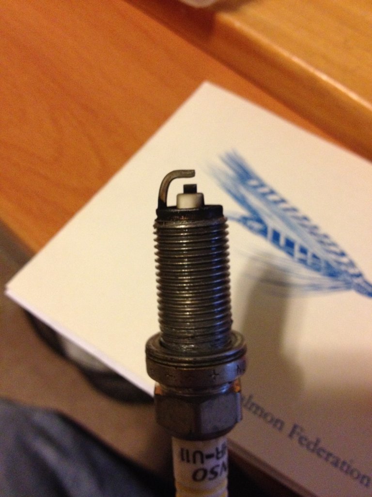

    here are two plugs will pretty low miles on them (like 5000 kms) . notice the fouling only covers like 180 degrees of the plug

    Dude you're overreacting. Put those plugs in and drive. I don't see a major issue. If there was in fuel delivery problem, you would most likely feel it, or have a CEL.

    Every other plug looks text book perfect, something isn't right

    Maybe it's normal. I would go out and pull one of my plugs in the same location to see if it compares just to make you rest easier, but its cold outside. Maybe tomorrow. Could possibly be some crazy technical stuff such as a funky burn pattern caused by the flow from the shape of the intake plenum on those 2 cylinders.

    That plug doesn't look fouled to me. Discolored a little, yes. Unless I had other problems, missing, fuel economy, smoking, I wouldn't be checking them every 5000 miles...
