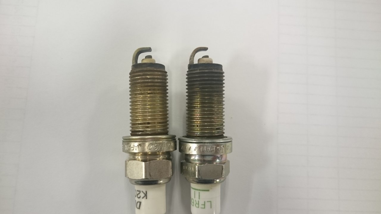

    So, misread that plugs were good for 100,000 miles in my 2006 v6...And here is what they looked like. Denso on left, NGK on right. The Denso's were around .048 gap, while the NGK's were around .068 gap.

    I've run both brands, and found the Denso's hold up better. That's my go to copper plug now.

    From my unintentional testing, I'd say you made the correct choice.
