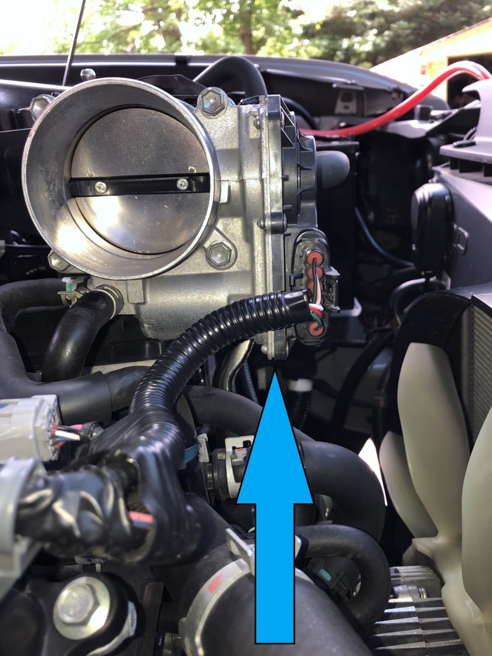

    I just got done checking for vacuum leaks on the top end of my 'Taco. The cigar method worked EXTREMELY well, that Harbor Freight pump smoked that cigar like no one's business and I got A LOT of smoke into the top end. I took a pic of the throttle body, I had it taped up well before the test, and you could see the tape ballooning outwards as I was pumping cigar smoke into the top end of the engine.
    During the smoke test, I saw a lot of smoke coming out of the area where the blue arrow points towards. The electronic side control of the throttle body. Shouldn't this be well sealed and not leak?
    I don't have a can of WD40 handy so I could spray under that to see if the idle increased while the engine was running.

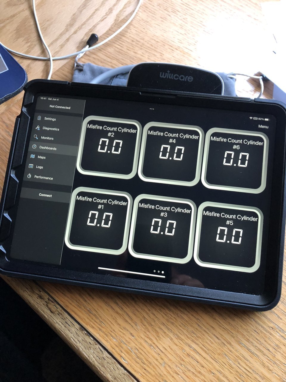

    Also, just got OBD2 Fusion installed with the 2018 Toyota Add On. The Veepak OBD2 adapter works well with it. A plethora of PID's to pick and monitor from. This thing is better than sliced bread!
    Set up a dashboard with Misfire counts on all cylinders. [​IMG] Now I'll know if those coils are misbehaving (I am suspecting No #3 and #4 coils). Better armed with more data to bring to the dealer next week. [​IMG]
