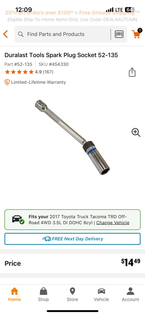

    A magnetic swivel spark plug socket helps a ton

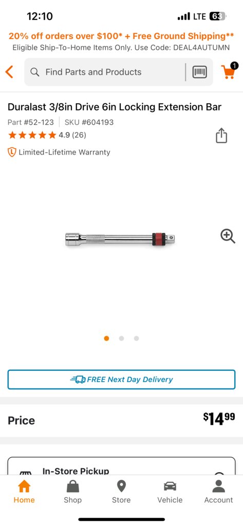

  6. Oct 14, 2024 at 10:12 AM
    Seymootaco
    Seymootaco Member
    Nov 20, 2023
    #437868
    23
    Quicksand tacoma
    My tools of choice

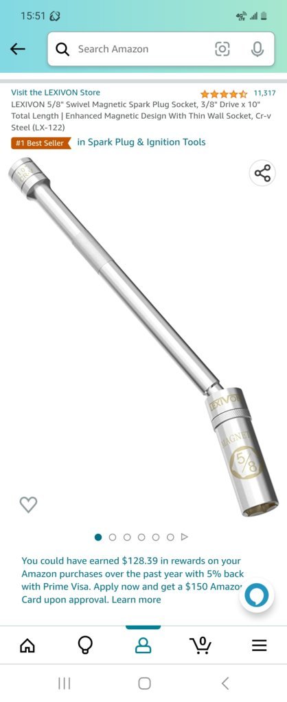

  8. Oct 14, 2024 at 11:14 AM
    Stevie17
    Stevie17 Well-Known Member
    Mar 2, 2023
    #419202
    4,218
    Stevie
    Crossville, Alabama
    24 Celestial Silver Sr 5 DCSB 4x4
    This is what I use and it’s a lifesaver
