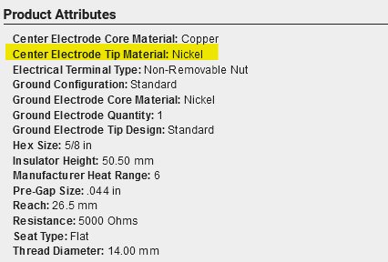

  19. Apr 25, 2022 at 9:27 AM
    #19
    Saffa
    Saffa Well-Known Member
    Sep 1, 2017
    #228826
    129
    Victoria, British Columbia
    2015 TRD Sport DC 6MT
    You are right, the cores are all copper, the tips are different metals
    Iridium
    V-Power
    Hook78[QUOTED] likes this.
