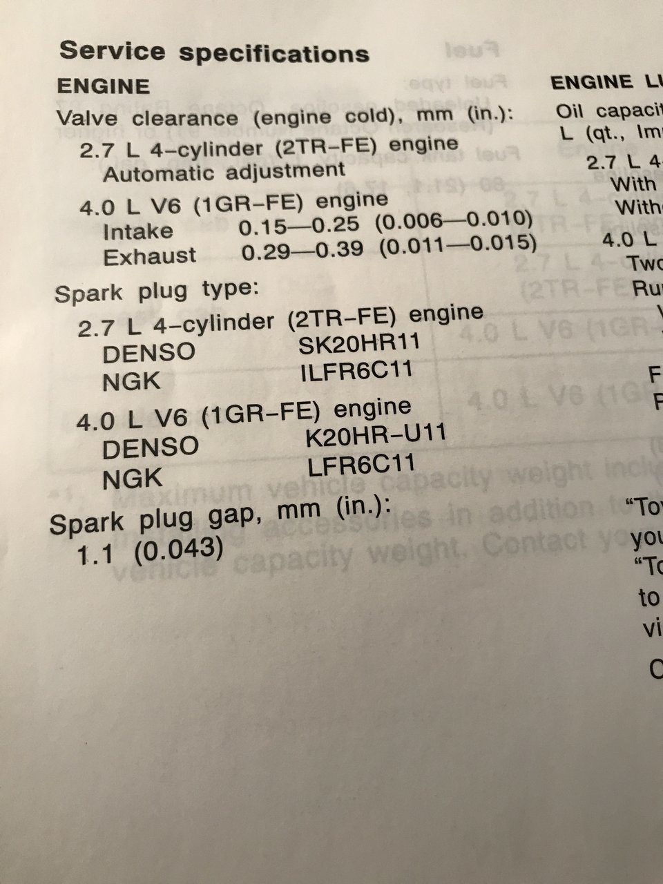

    The owners manual states the gap should be 1.1 mm or 0.043 in.

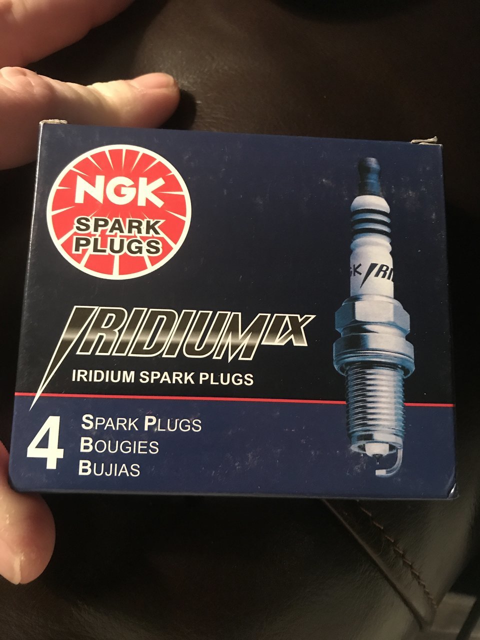

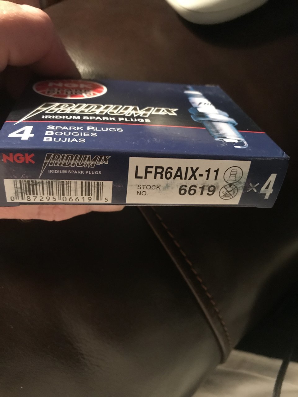

    They are good! They are what I am running in mine and were recommended in a thread a few months ago.
