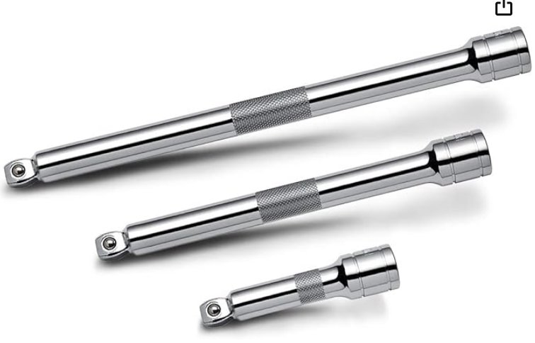

    A set of "wobble" extensions will really help. Notice the socket end is machined such that the socket can "wobble" about 15 degrees in any direction. These are great - however sockets can tend to slip off more easily.

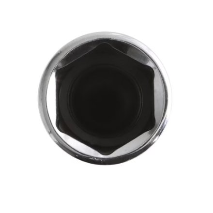

    I have a spark plug socket I've used for decades. It has a soft rubber type liner so there is less likely chance to damage the porcelain on the plug while installing or taking off. It also "holds" the plug until you give it a tug to take off. Other than that I use my 3/8 " socket/ratchet set. If you don't have a full set I'd suggest a standard 3/8" ratchet, 3" extension, 6" extension and a 3/8" flex joint. Will come in handy for all sorts of work besides spark plugs.

    This is a pic of a spark plug socket with the rubber liner. Don't need to worry about a magnet. Home depot and probably others sells them. Just get the right size for your year and model.

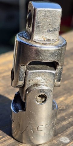

    I would be worried about that swivel right at the top of the spark plug trying to thread it into the hole'
    a solid extension would make it easier to thread it without cross threading it. IMO

    Thread them in by hand and not with an impact and you'll be fine. A solid extension actual puts more stress on the threads since it doesn't compensate for angle and how you're twisting whereas the swivel does. I've never had spark plugs thread in easier than with this socket. Don't buy it if you don't want it. Stop overthinking everything.
