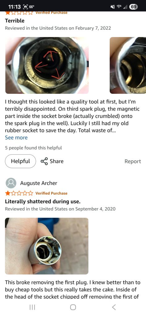

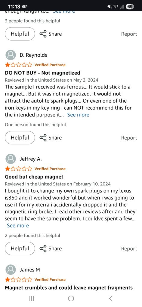

    I personally prefer rubber inside spark plug sockets for the protection against cracking of them.
    My tip with them is to shoot some silicone spray inside first before the job to prevent the rubber/socket staying on the plug
    I have a Mac Tools set but I believe they're just a standard 5/8"(16mm) hex plug. I'd just run to the store and get a spark plug socket you like the name of.
    I also like changing my plugs with a locking extension. Lexion and Vevor tend to be decent for diy purposes from Amazon. For store bought, I would go Harbour Freight/Princess auto
