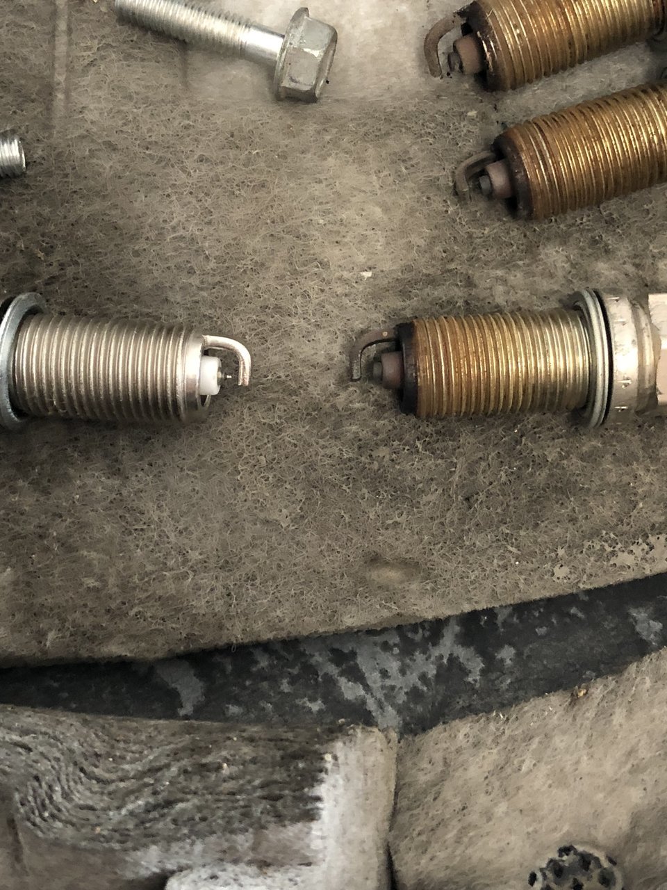

    Stick with oem I went to NGK an 12000mi later had a misfire code pulled a plug an found this had right gap. Swapped denso in an no issue since.

    Just changed mine at 65k. Previous owner hadn't changed yet and the original denso's look much better than the original NGK's. Installed denso's back in it. Runs a little smoother also.
