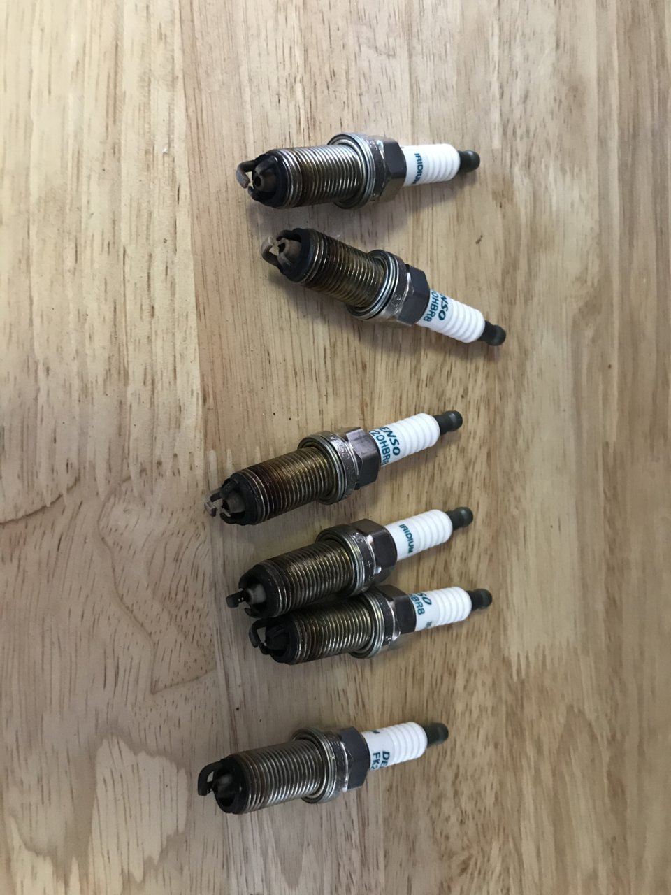

    I did change my plugs at around 59,000 miles. That is some good information in your next post. In one of these threads on "spark plug replacement" I have the photo of my old plugs. I think the plugs I took out had some of that corona stain that you were talking about.

    The above is the comparison of new and old plugs from my 2GR-FE at 100k miles. You can see they still didn't look bad at all and easily could go further, which is why Toyota recommend 120k miles for those port injection only engine.
    The 2GR-FKS with all that direct injection, is doing a number on those spark plugs, there's a reason Toyota recommend 60k miles.
