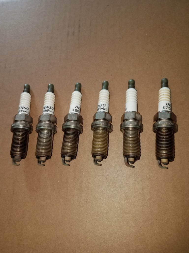

    I can confirm my 2014 OM specifies Denso Copper plugs for the 4.0L V6.
    Part number: Toyota OEM: 90919-01235 Denso: K20HR-U11
    +- $7.00 each from a dealer and worth every penny. These had 115,000 miles on them when I replaced them at 132k... and honestly I can't discern any change in performance or gas mileage.
