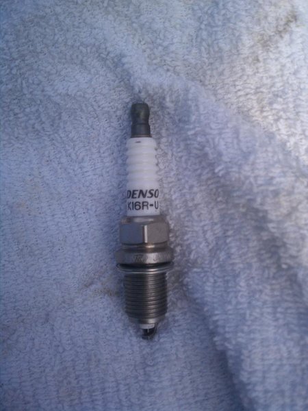

  6. Jan 5, 2012 at 10:05 AM
    misterdmac
    misterdmac Well-Known Member
    Aug 10, 2011
    #61478
    185
    Doostin
    In or around the truck
    '97 2.7L DLX
    This is the plug that the dealership will supply you: Denso K16R-U, single electrode pre-gapped at 0.031. I bought a set yesterday for just under $12.
