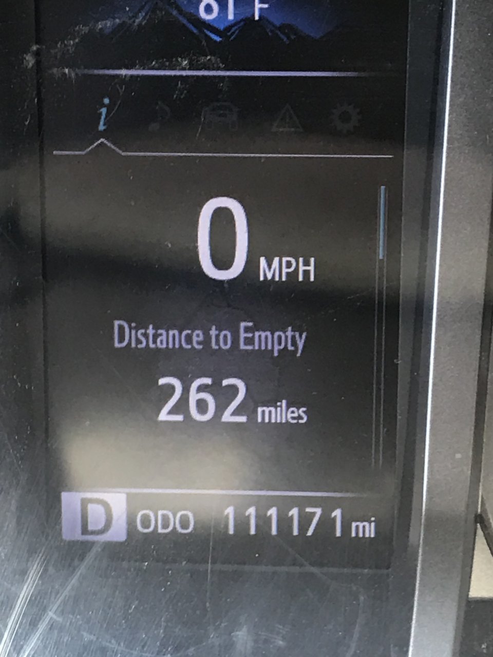

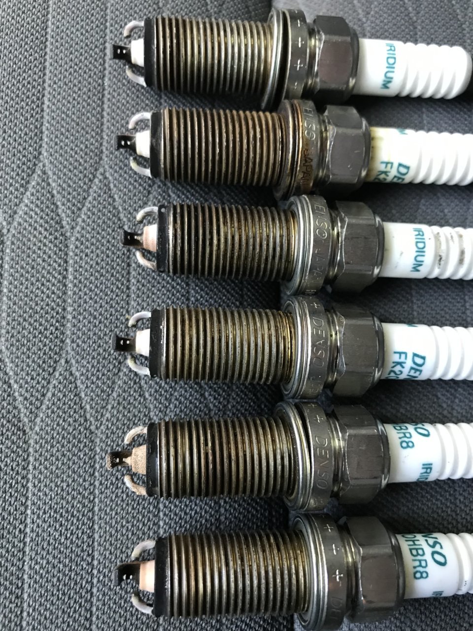

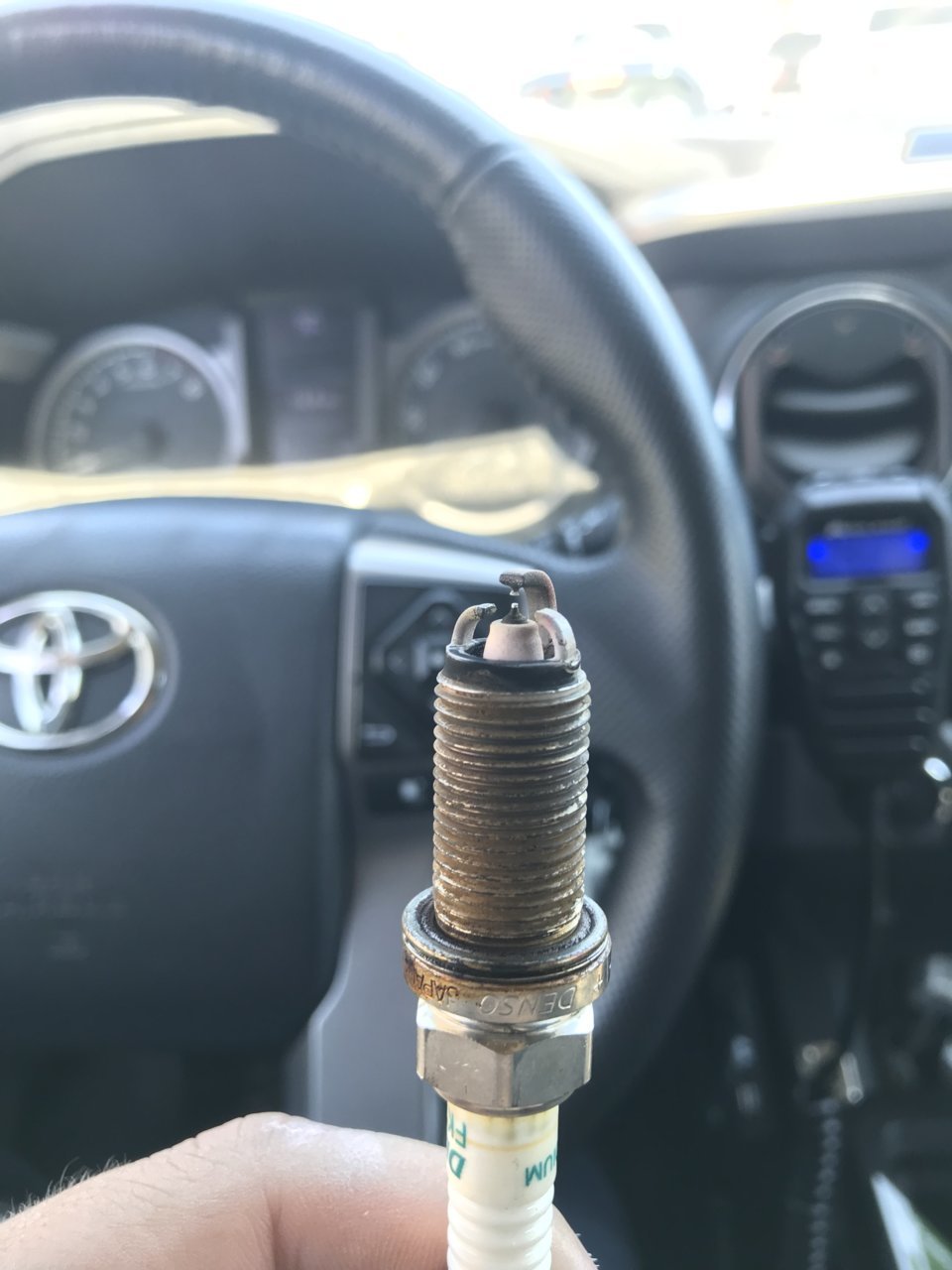

    Thought I’d share a quick picture of my spark plugs since there seems to be some questions about replacement intervals. I’ve heard 30k, 60k, 120k.... Ran these until a hair over 111,170 miles, truck ran fine before and I can’t tell any difference after the change out.

    All u mechanical wizards out there, what causes the electrode to pop off and stick to the strap? Good job op, I'll probably replace mine around 60-80k. Didju sneak the plugs out or pull the plenum?

    I find it interesting some are slightly darker colored than others, where ya at Engineers?

    its an electrode coating. probably platinum, or some such.. all spark plugs, caps and rotors start to degrade, and wear like this.. each ignition corrodes the electrode surfaces by the tiniest bit.. eventually it wears down... and they look like this....
    notice the edges are rounded, and the electrode is rounded, and almost melted... just due to age, maybe slightly too hot.. but mostly due to age/use.

    about how long they last
    iridium and platinum plugs are ~100,000 miles. slightly harder to spark but last long time. NGK officially says 50,000 Denso says up to 120,000 for twin tip iridium
    copper are 30,000 they have better spark but wear much faster
    and it is not so much wear, it is the increasing gap as they wear. platinum and iridium maintain gap distance far better

    Higher heat for extended periods. Nothing to worry about.
