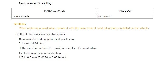

    They appear to be Denso Iridium Long Life plugs, part # FK20HBR8.
    According to the stealership, for the 3.5L V-6, Toyota part #: 90919-01263

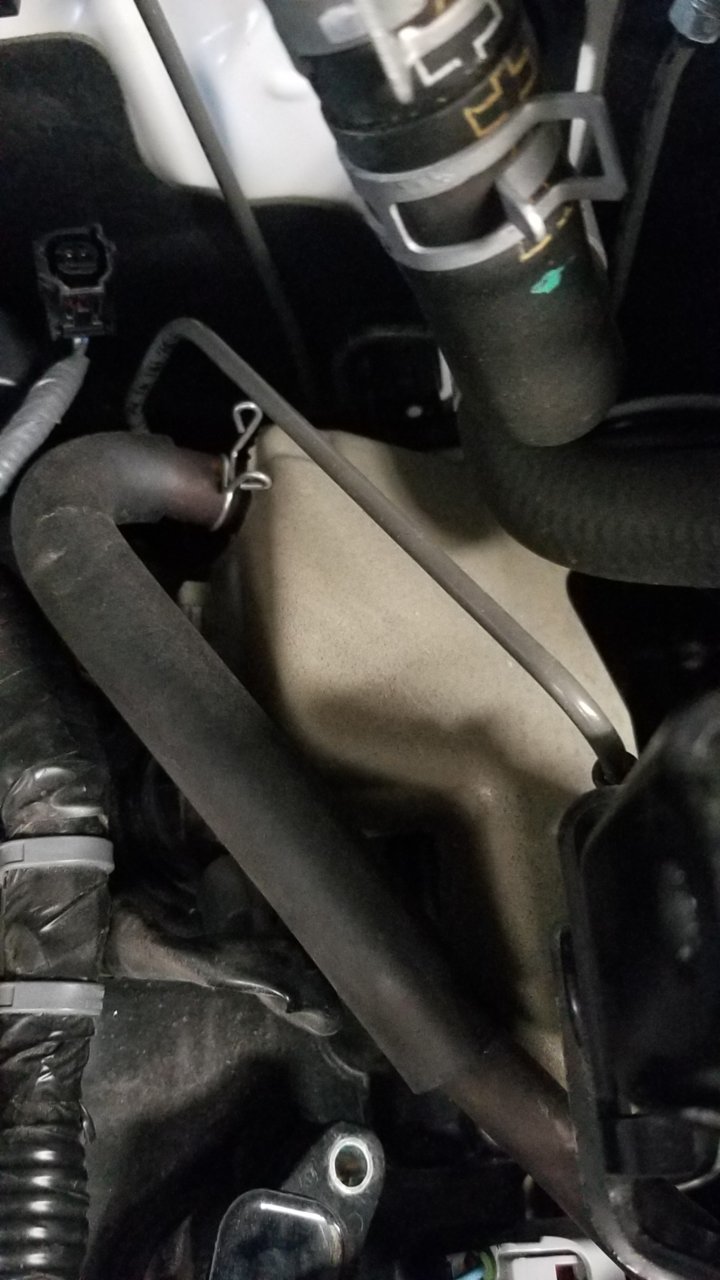

    Should you probably not this first time it was an orange o-ring type gasket with some form of oily lube on it. The gasket never popped out of the upper intake, I left it at bay. On re-assemble I stuck with a cross pattern and torqued to what i thought was right. It was a fairly simple process the driver rear cyliders have a few hoses that need to be pushed out of the way. Very last cylinder has a insulation cover that needs to come off. Pass side is the easiest, but pull the intake first and work towards the passenger side is what I learned from doing this. The plugs were denso and I installed denso plugs.
    Hope this helps anyone trying to do this
    Mentioned insulation cover
