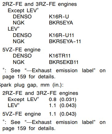

    I got a 2000 Toyota Tacoma 2.4L automatic and I’m wondering what spark plug gap I should be using .032 or .044? And why is there two options but no specifics when to use what gap?

    It depends on if your truck is LEV or not.
    Look under the hood for the emissions sticker.
    It will say if it is LEV or not.
    The plugs are not the same for LEV and Non-LEV.
    Once you know what if your truck is LEV or not, use the chart below to get the correct plugs and gap.

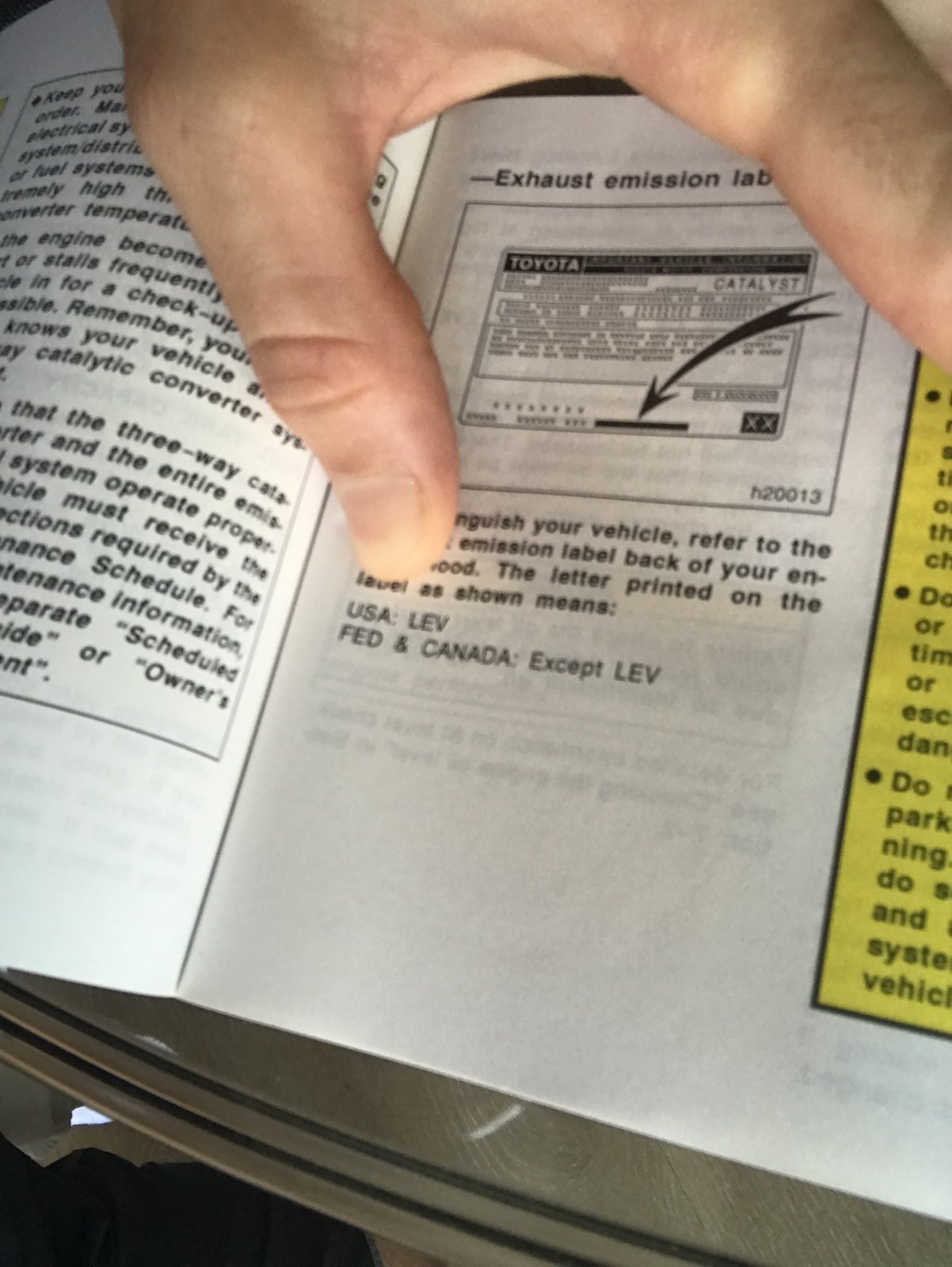

    my hood has been replaced so I don’t see the emissions sticker but from when I changed my IAC I remember I have federal emissions not California emissions. I read USA = LEV and Canadian = except LEV can confirm?

    So it's a federal truck, not the funky CA version, they have a coil on each plug.

    No, you don't have a LEV, it's just a reg one. LEV was CA only AFAIK and they have 4 coils. You have two.

    I appreciate you soooo much rn while I was waiting for your reply I ended up calling my local dealership and they didn’t seem to know what I was asking supposedly their manuals don’t say the samething so they input my vin and gave me my original spark plug part number which directly correlates to the LEV spark plug in my manual. Meanwhile I knew I had FED emissions from when I changed my IAC I just didn’t know if that meant LEV or Except LEV… they even had me second guessing my manual which says this So maybe my whole rough cold start then phantom hesitation under load while cold is because these wrong plugs!!!! Not my coils or wires but simply this gap! What do you think?

    The plugs parts numbers are almost identical if you look above in TnShooters comment the numbers on the right of Denso or NGK specify part number and is only different in the numbers at the end. Regardless I’ve been running the .044 gapped plugs and seems like I should be running the .032 gapped plugs from my understanding now which could cause a rough cold start I’d assume. I guess I’ll start by changing my plugs to the correct ones and see if my problem persists assuming the ignition coils haven’t been damaged.
