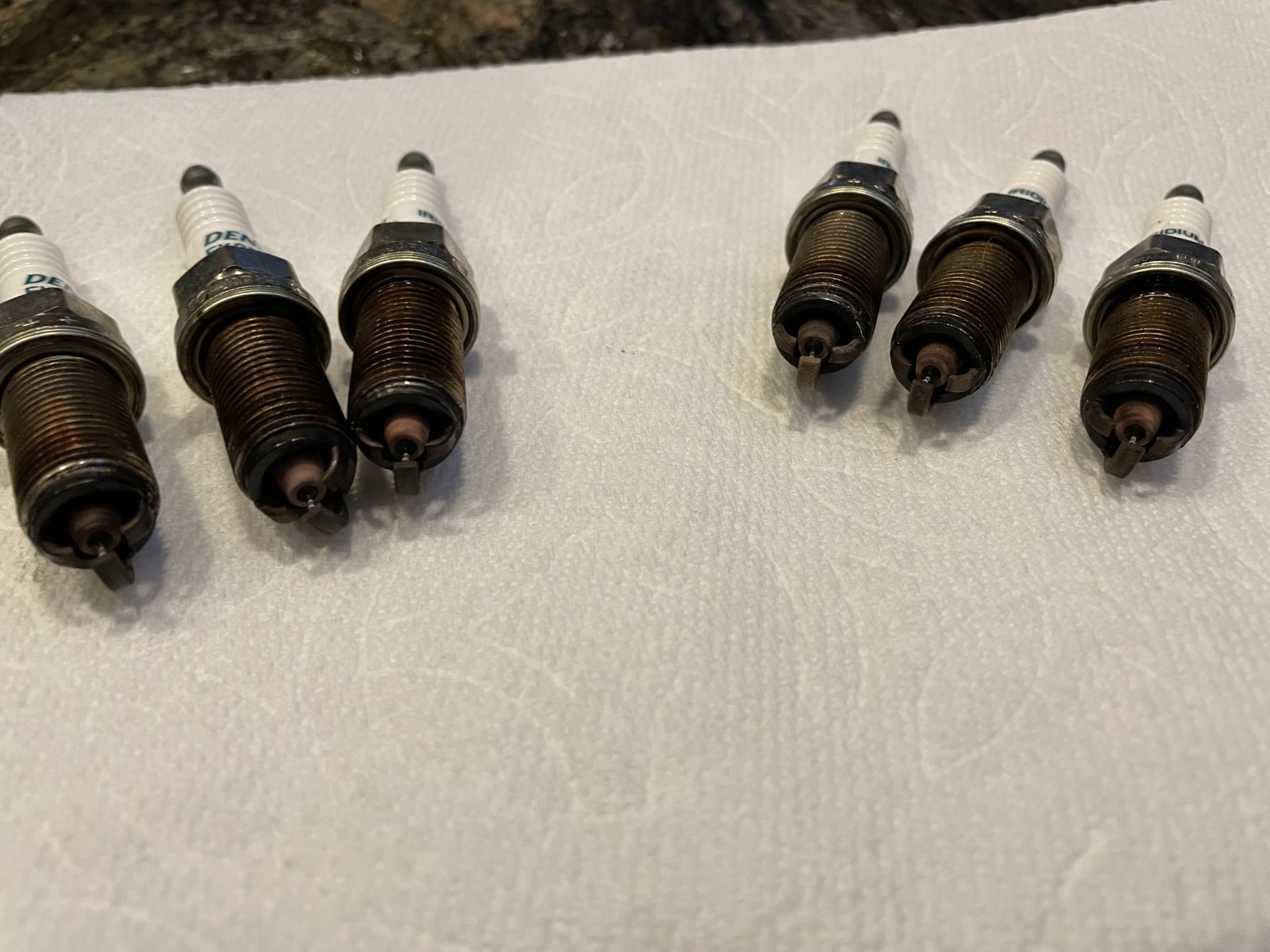

    Just did all six, wasn’t terrible but some of them were covered in oil.
    is that common since they were loose? Two out of the three on both sides were loose.

    That’s just oil sipping where they were loose. I wouldn’t be concerned with it unless you notice it drinking oil.

    Normal, same issue with loose plugs from the factory and oil on threads. A dab of anti seize on the spark plug threads and a dab of dielectric grease in the ignition coil boot. I didn't torque them, hand tighten only then a little more.
    Truck was about 6 years old with 18k miles when I swapped plugs.
