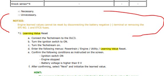

    When we started messing with OVT tunes, we quickly found out that the battery disconnect does not do anything to ECU. If you are replacing/servicing some engine components, you need to reset learning values by using scanner's function (techstream ot other). The reset you have done probably reset Combination meter Control unit so it started calculating mpgs.
    Here is Service Manual note:
