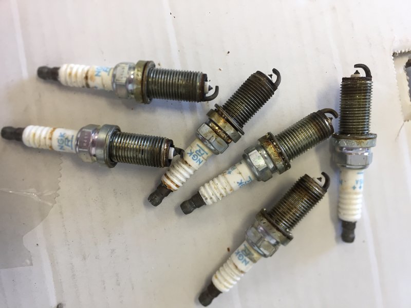

    Did my spark plugs was super easy thank You everyone for the help and advice! Thanks Tacomaworld !!!! The only thing I found weird was both driver side and passenger side had Ngk r spark plugs part number PLFR6A

    that probably means that they've been changed in the past. how do they look?

    Means someone changed them before. Those are platinum plugs which usually allow for a longer service interval than the standard plugs.

    I will take a pic and post

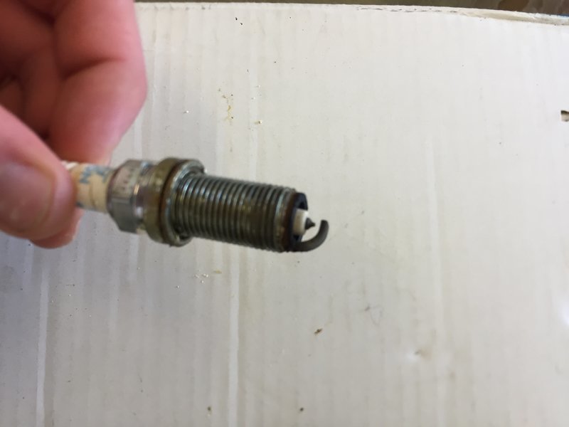

    Hopefully you guys can tell but they look fine to me

    yea im no expert, but they don't look bad.

    Probably could have gone longer on them but oh well they are changed and now I know
