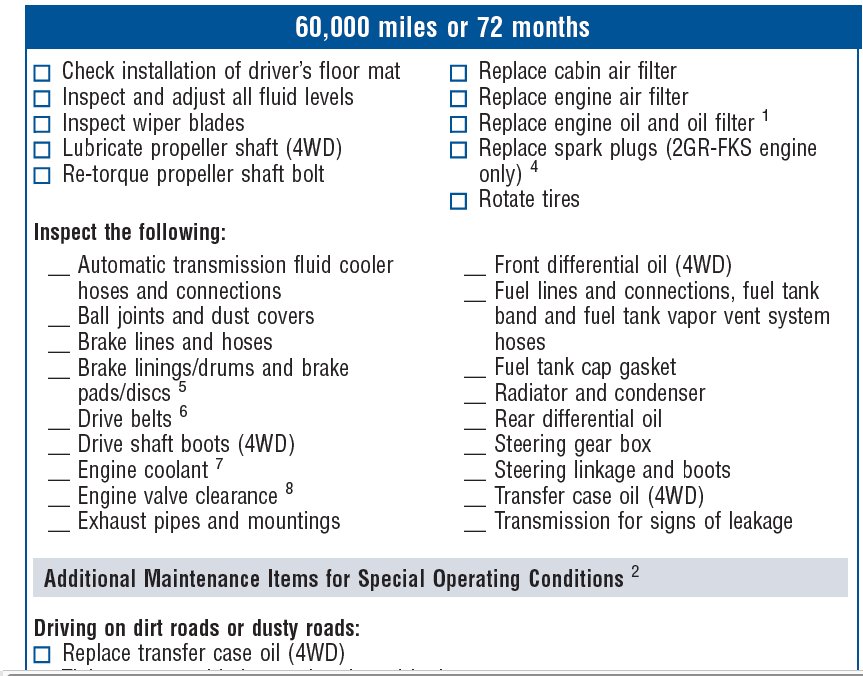

    Always thought the new spark plugs lasted 100. Maintenance manual says change every 60k.

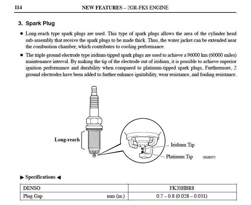

    The Owners maintenance manual says 60k as does the information on the 2GR-FKS 3.5-liter engine.
