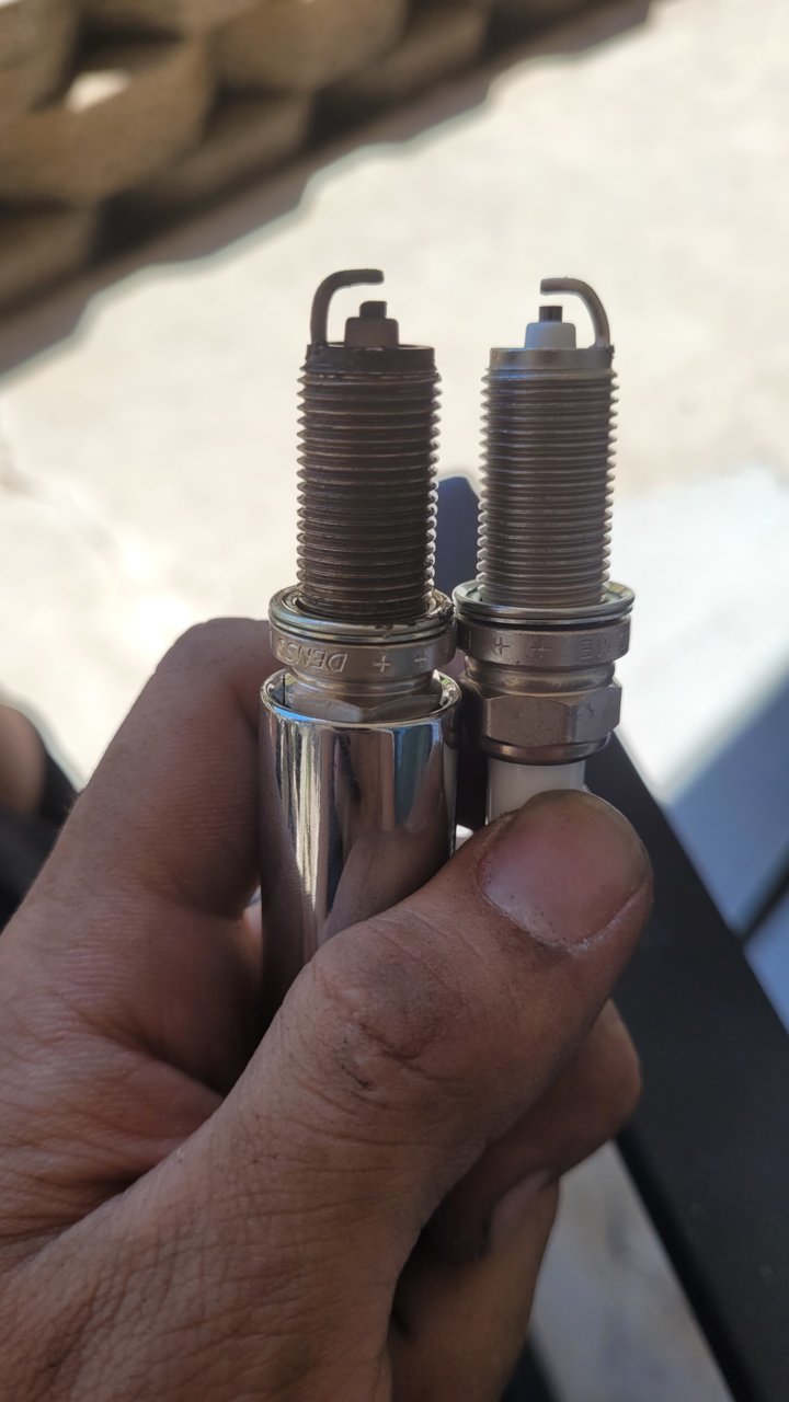

    Denso k20-hur11 on both banks. The 4.0 likes the hotter burning copper. Some change to iridium with no ill effects though.

    SC 2.5
    I actually went 125k on my last set.... I severely neglected my spark plugs while doing all of the other major maintenance. The biggest issue that merited a spark plug change was that I was getting 150 miles to a tank and sluggish performance.
    The gap was .061-.063 after I pulled them.

    2009 DCSB V6 TRD Sport 4x4
    I'm curious as to what mine look like as well with the mileage I have on 'em... Not noticing any issues with performance/power or gas mileage, but once I change 'em out, I'll gladly share a "yes, change your plugs regularly" and/or post what my new experience is and a photo as well. Thanks for sharing that photo!
    will.i.was and TnShooter like this.

    SC 2.5
    It wasn't too bad of a drop off in performance but just enough for me to notice. It definitely helps that I changed them out though, my truck idled completely different afterwards lol but I'm sure that's how it supposed to be anyways.. yep, always change your plugs and check your gaps haha
