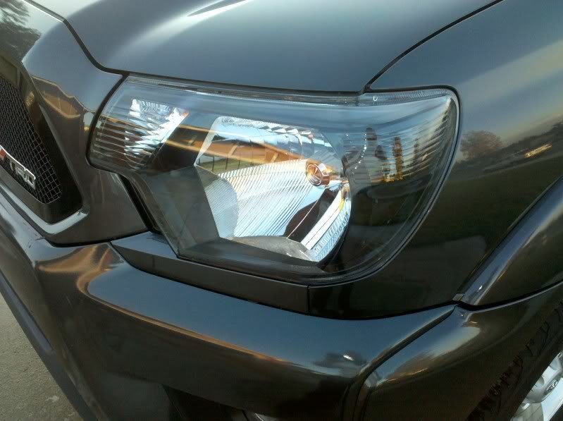

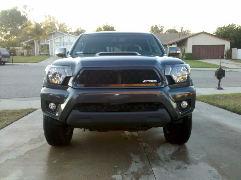

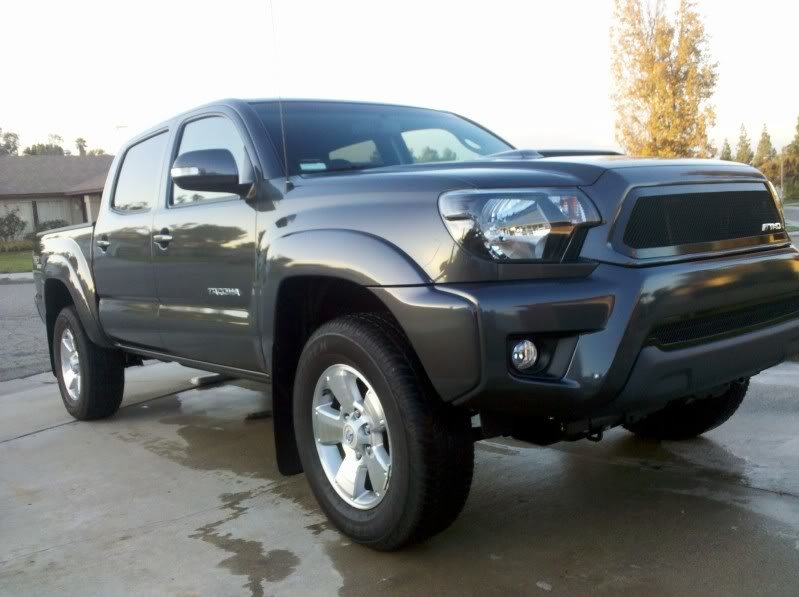

    Well Here is the Start of my build on my 2012 Trd Sport...
    1. Black mesh Grill from (T-rex Grills) Corona,Ca
    2. Horn Relocation Mod
    3. Disengaged DTRL's
    4. Black Head Light Mod
    5. TRD Grill Emblem
    6. H.I.D. Fogs/Headlights, and all super white LED's

    Wow that BHLM looks great on Mag Grey!!! I'll have to do that... was it too hard?

    Got a question and a favor to ask! Question: Do those lights on the rear view mirros light up at night? Or are they just for turning??
    Favor: Can you post up a night pic with those on?:eek:...thanks

    Hey guys thanxs for the comments.. As far as the grill goes im not sure the part number, they did not have one for 12's yet and used my truck to design it. All I did was leave my truck there and they told me to pick which design I wanted. I chose the black mesh with out studs, and matching bumper grill insert. Ill pick the hood insert up after this weekend. The headlights are not hard just VERY time consuming if you want them done right. I sprayed my bezels with krylon fusion (black gloss) and Pre burned them right after at 275 for 5 minutes. Then left them in the oven for 5 hours at 170 to cure better and faster. Some people reading this might not agree or have different opinons on curing items or painting in general. Ive worked for two autobody shops, and for that company APC which made all the euro tail lights bulbs etc. While there I worked in paint/fiberglass/ department building all there show cars EVERY CAR PICTURED ON THERE PRODUCT CASES AND CARS AT SEMA. Id say I have a decent back ground in this area. Anyone getting a grill Id recommend the horn mod, it was super easy and made a huge difference. H.I.D.'s and all bulbs will be getting replaced xmas time. Hopefully some tint and a flesh bed cover to.
