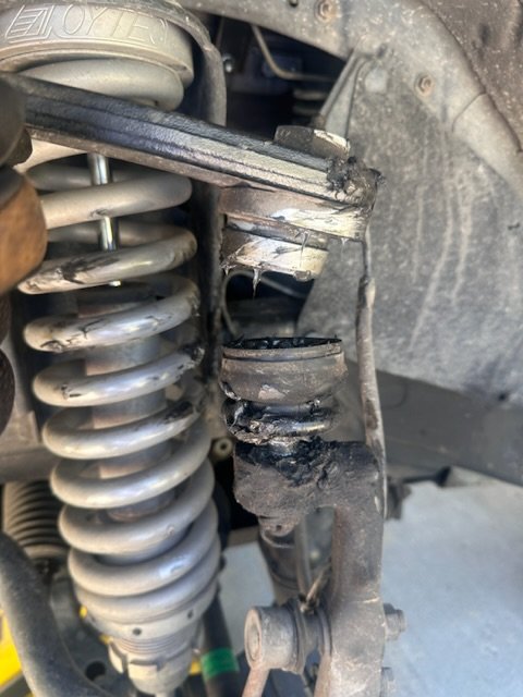

    Wanted to add a data point for anyone googling out there. Just had the old design UBJ on my ‘09 sport totally separate while driving in a parking lot with under 20k on them. No warning or noises leading up to the failure. Trucks lived a pretty gentle life during those miles and plenty of grease.
    I’m hoping the “new design” is more then just the removal of the grease option. That being said, the old p/n is still in circulation and I almost bought one until I real it had been replaced with p/n SPS-35102.

    I reached out to SPC and they wanted me to start a warranty claim, but denied it due to being purchased in 2019 regardless of mileage on the parts (19,000~ miles).
    So I would probably just avoid SPC if possible. This junk will be coming off the first chance I get...
    I'm not even really mad about the warranty timeline, the part that concerned me was that this item was a known high failure rate item that required a complete redesign. Would have been nice to get a heads-up that I had a ticking timebomb in my suspension. I had zero clue until it catastrophically failed with no symptoms. Hell, maybe even discount on an early replacement with the new model before it killed my family would have been a solid thing to do. Instead the wheel collapsed in my daughters preschool parking lot...
