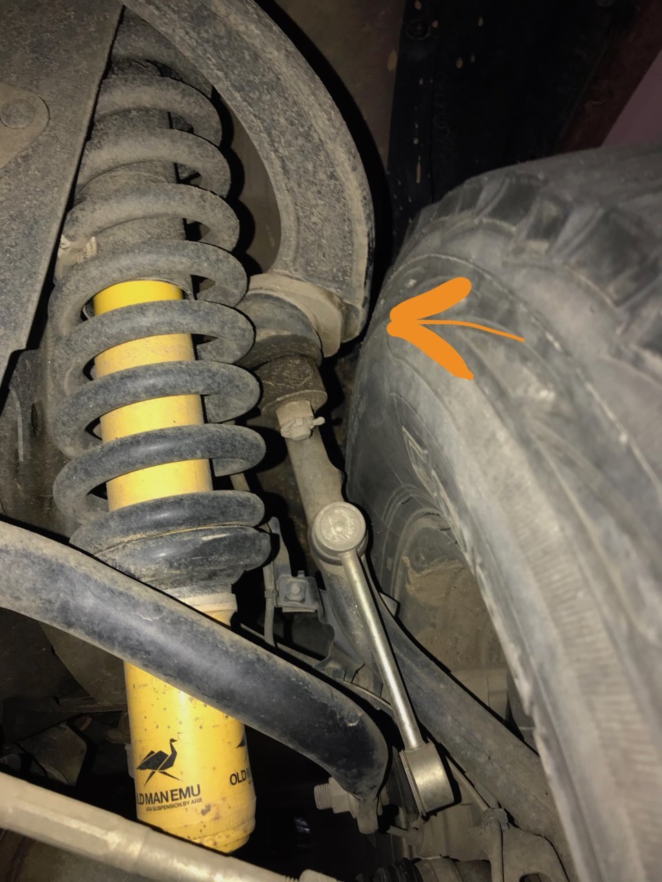

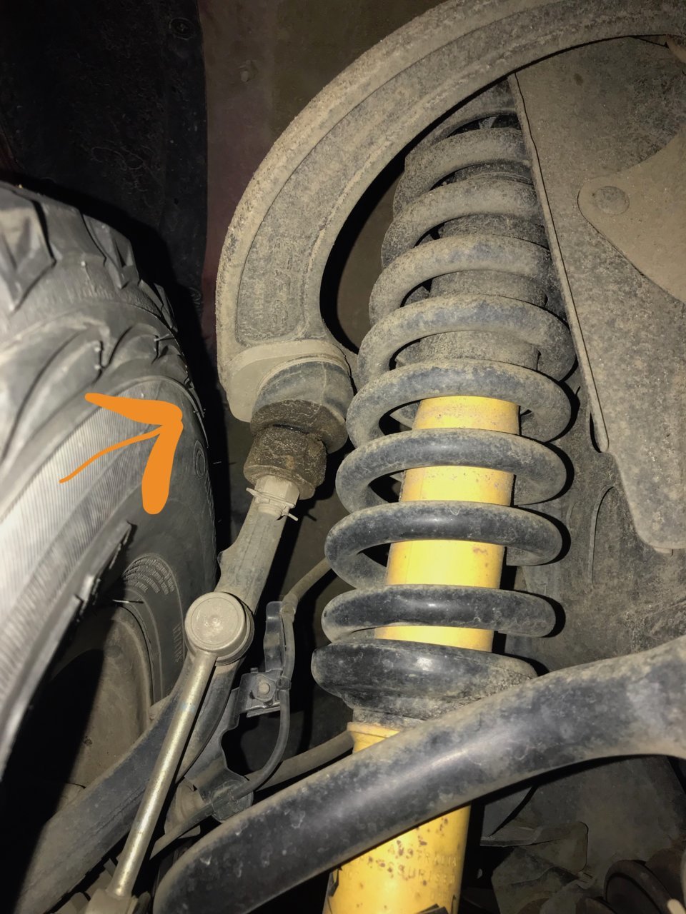

    Agreed. I've had the updated ball joints with no problems, just grease at every oil change. Only thing I would recommend is to set the ball joint as far out as possible and then get an alignment. I didn't, and now my tire will rub on the UCA when aired down. It only rubs on the side where the ball joint is centered.
