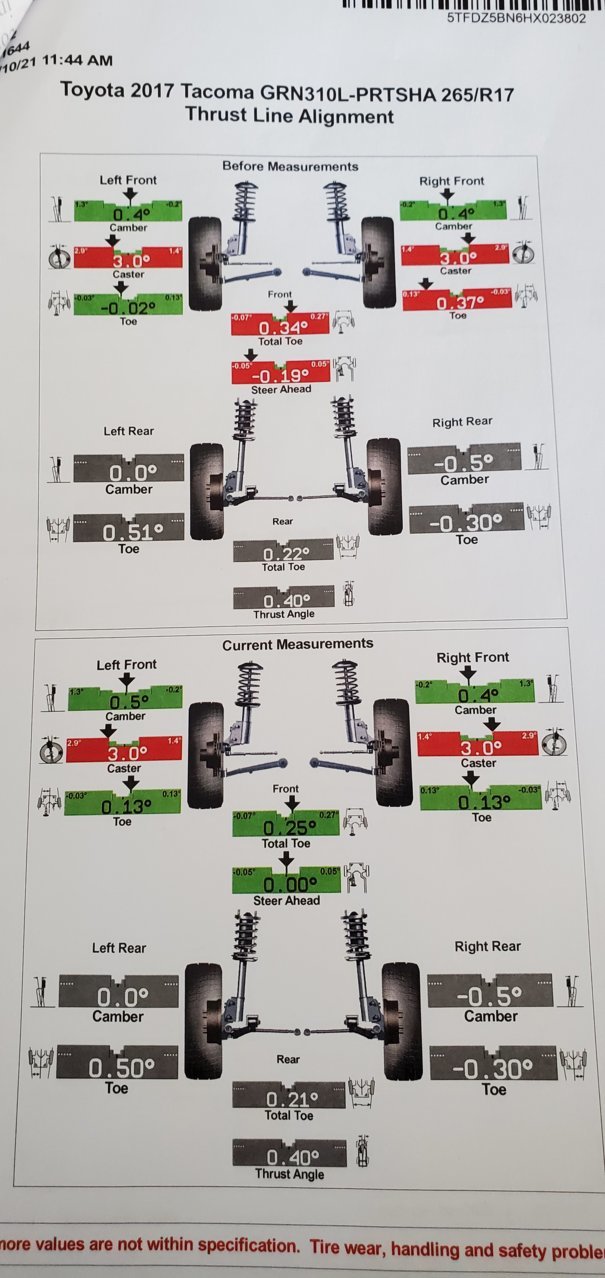

    I struggled to have my truck aligned for a long time. 3 shops later and a small hole in my wallet. That was almost 2 years ago. Yesterday i was at Toyota for some service. They told me i can have a free alignment check and they would report back to me. They went ahead and aligned it stating it was out. My steering wheel for sure does not seem 100% centered anymore. I also believe i have too much toe now.
    Can anyone with a similar set up or knowledge on the subject chime in here

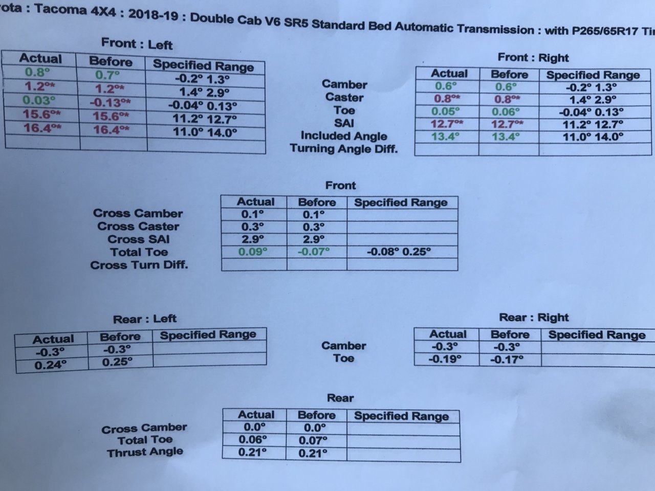

    Based upon the numbers it looks better.

    It's near perfect, your rear axle is a little off, but nothing major.
    I'd be happy if that was my truck.
    I max camber and set toe high with bigger tires. They push outwards as you drive.
    Your BFG's aren't doing you any favours.

    They charged you for that? Wow. Not the most impressive toe set by any means. Nothing wrong with camber or caster. Obviously red because of the UCAs, but your toe was high meaning your wheels were pointed slightly inward. They brought it back very slightly and you are sitting on the absolute high end of the spec. I would not be happy with that. Matter of fact, I would probably be pissed. They should have set your toe somewhere around .06-.08. You are going to be wearing the outside edges of your tires with them leaving it to high. Technically they can tell you that it is in spec which it is because it is so broad, but if they adjusted it, it should be spot on.
    I really don't like they screen shot printout they gave you. They do it because they don't want anyone to question their work. This is what your printout should look like - bf73584b-5dad-4bcc-a77a-b09a6ace7d50-jpg.3713352 (1280×960) (twstatic.net)
    Edit. Haaaaa, now I see what they did. They set your toe equal on both sides. What a f'ing idiot. Your steering wheel was not off before, it is now for sure. Let me guess, turned to the right to go straight? Please go back and raise all kinds of hell for that nonsense.
