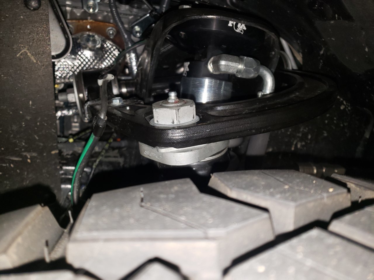

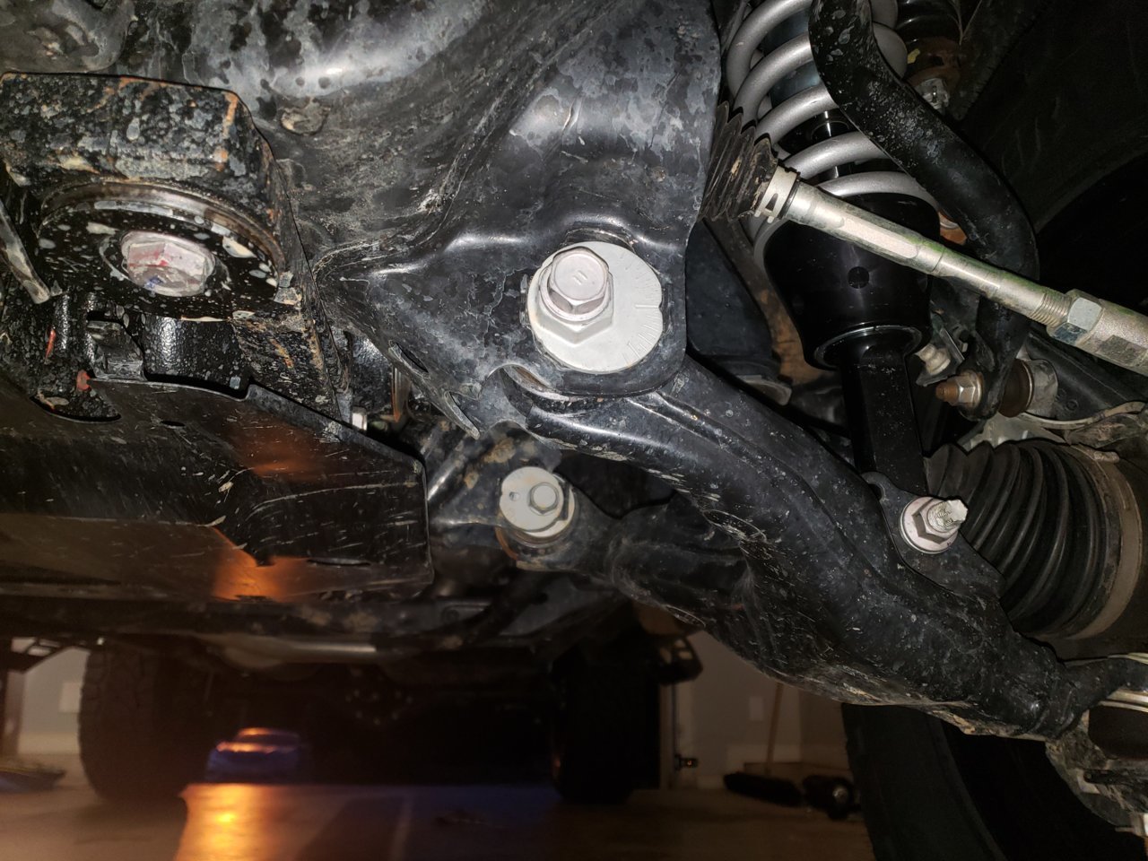

    Thanks for the info guys. I've been super busy at work and just now getting around to the alignment. I have the lower cams max out positive. attached is a picture. My question is on the SPC upper, is this the correct position I want this in? This is the driver side and the SPC is facing towards the rear of the vehicle. Making the rounded portion facing towards the front middle of the vehicle and I would be position F.
    Thanks guys.

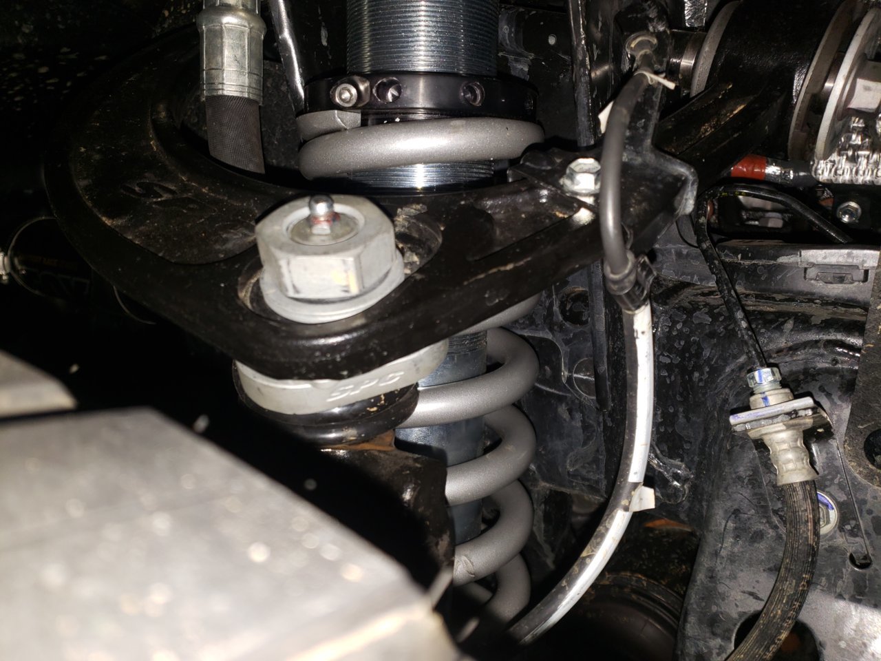

    Here's a better picture of the passenger side.

    That does appear to be the F position. Whether or not that's where it needs to be can only be determined by measuring the caster.

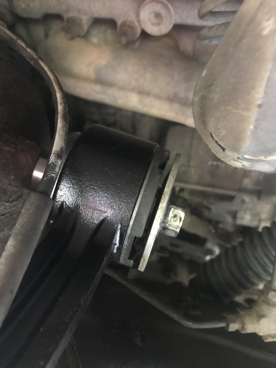

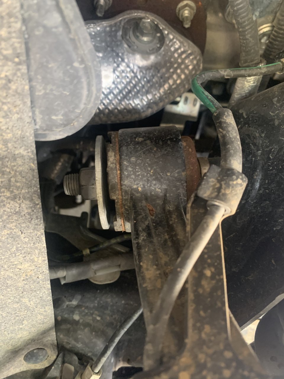

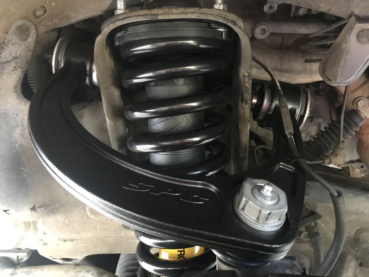

    A shop installed mine today but this gap seems off. Is that how it should look?

    That's right. There is a metal bushing in there that keeps that gap open.

    Just to give you more confidence...

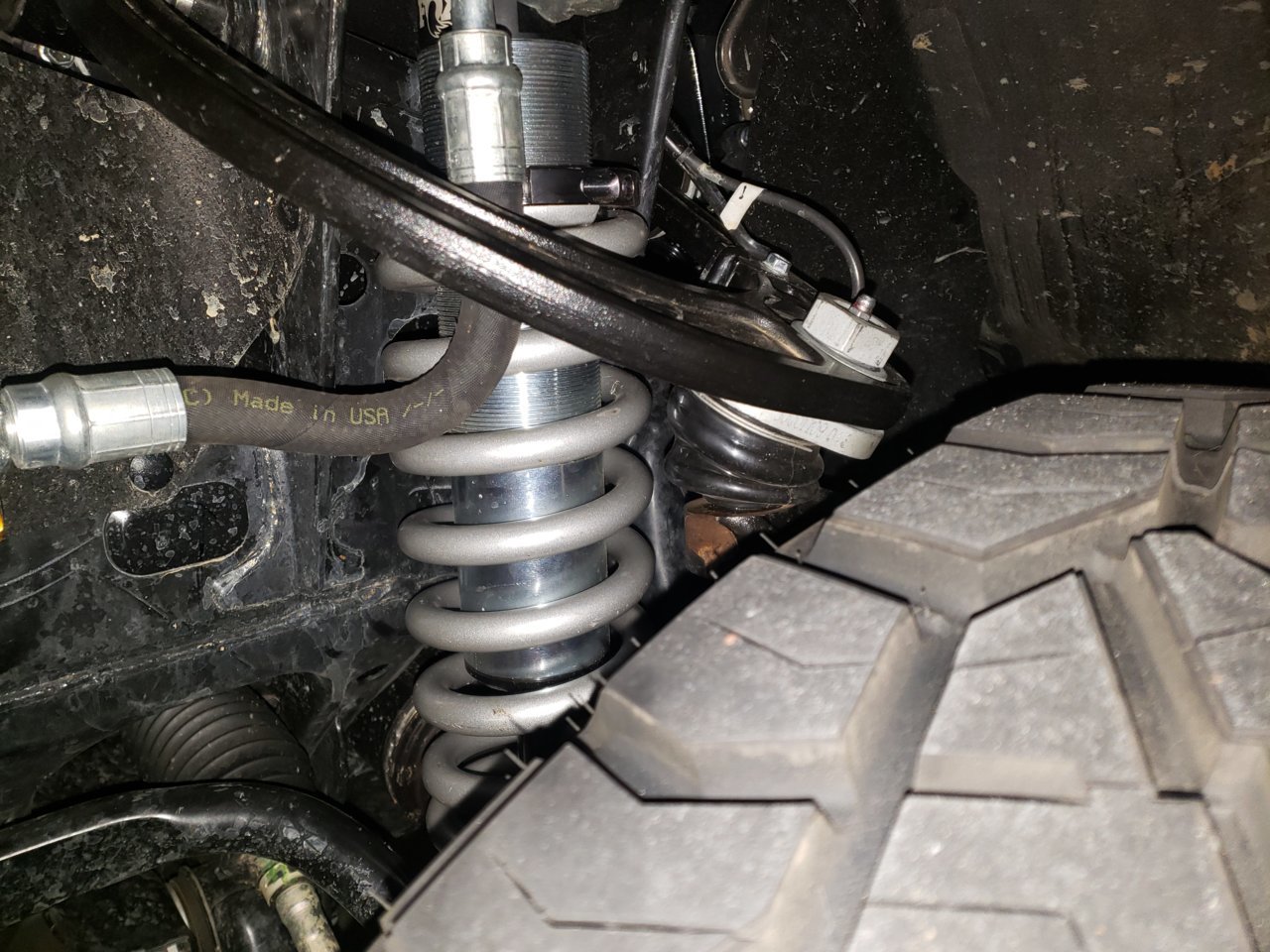

    :thumbsup: Do they stay quiet despite picking up some surface rust?

    No noises to report here. Honestly that rust was a little surprising given where I live.

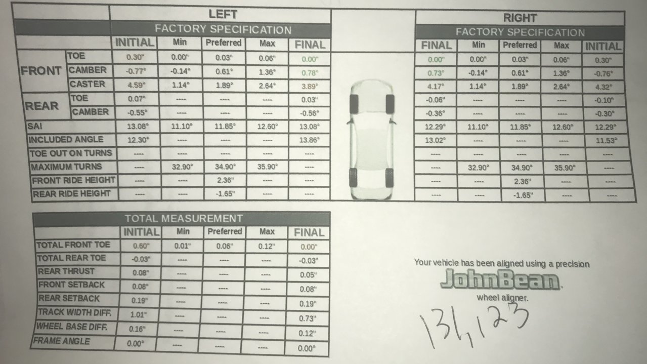

    Sorry for continuing to hijack your thread OP... I’m curious what everyone’s thoughts are on these specs. When viewed head on it seems like my tires tilt inwards towards the top. Does chamber look reasonable?
