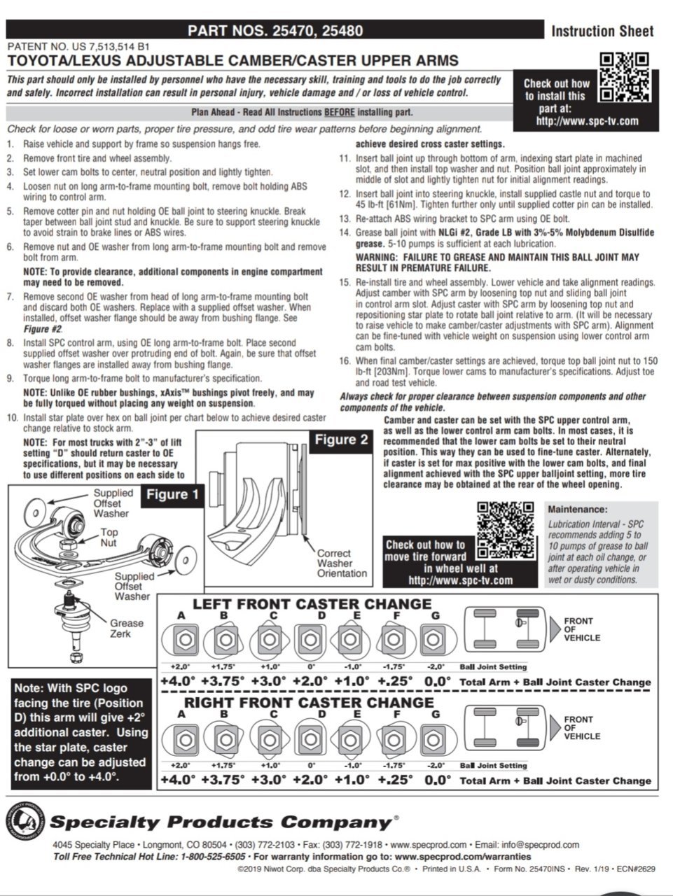

    1. Those coil overs are the worst. They put to much strain on the suspension geometry.
    2. Put the SPC joint to position D pulled all the way out and torque the nut to 150ft#'s.

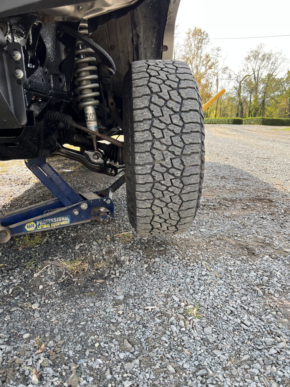

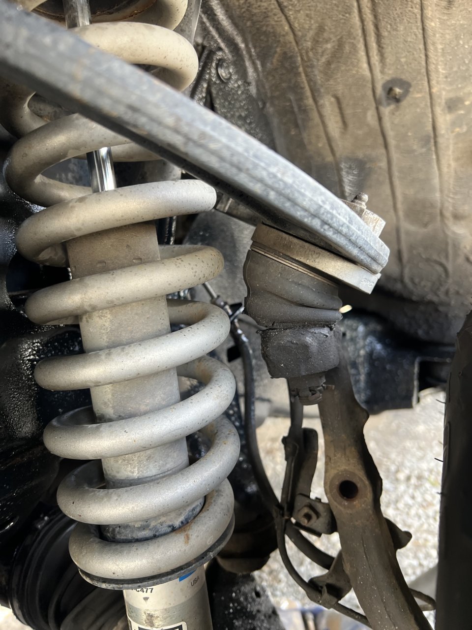

    :thumbsup: No rubbing

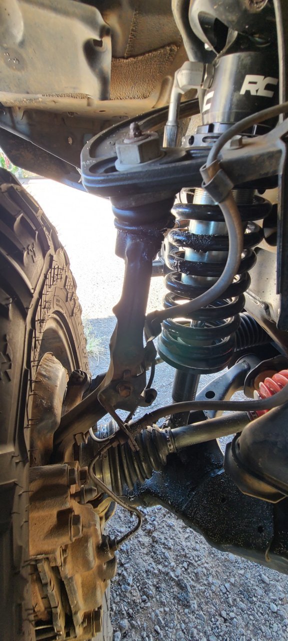

    It depends on how high your lift is the higher the lift the more it droop down. I bought mine set to 3.5" reason why is, with my front heavy bumper would bring it back down to 3" lift 3.5" is maxing it out and that's why my uca droop down and hits my coil. I did have a 3" lift with ome coil never had this problem.

    mine is on the D setting

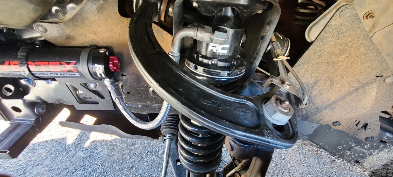

    I am also on the D setting. 2.5* (ish) caster 0* (ish) camber 3" +/- lift

    OP they make boot replacement kits, you dont need to replace the whole ball joint if its still good.
    Like others have stated slide it out and lock it down, you SHOULD be able to get proper camber with the D setting without having to slide it in to get clearance between ball joint and coil. Thats how my SPC arms are.

    i bought a 3inch kit with 620 springs so after settling and a bumper I’d say I’m sitting around 2.75inch? From the top of my 285s to the bottom of the fender flare is just under 6&1/4 inches.(I’m not sure if the truck was perfectly level when I took the measurement) Hope this helps

    so if you put your ballpoint all the way out on the slider you should be fine and have no rubbing :thumbsup:

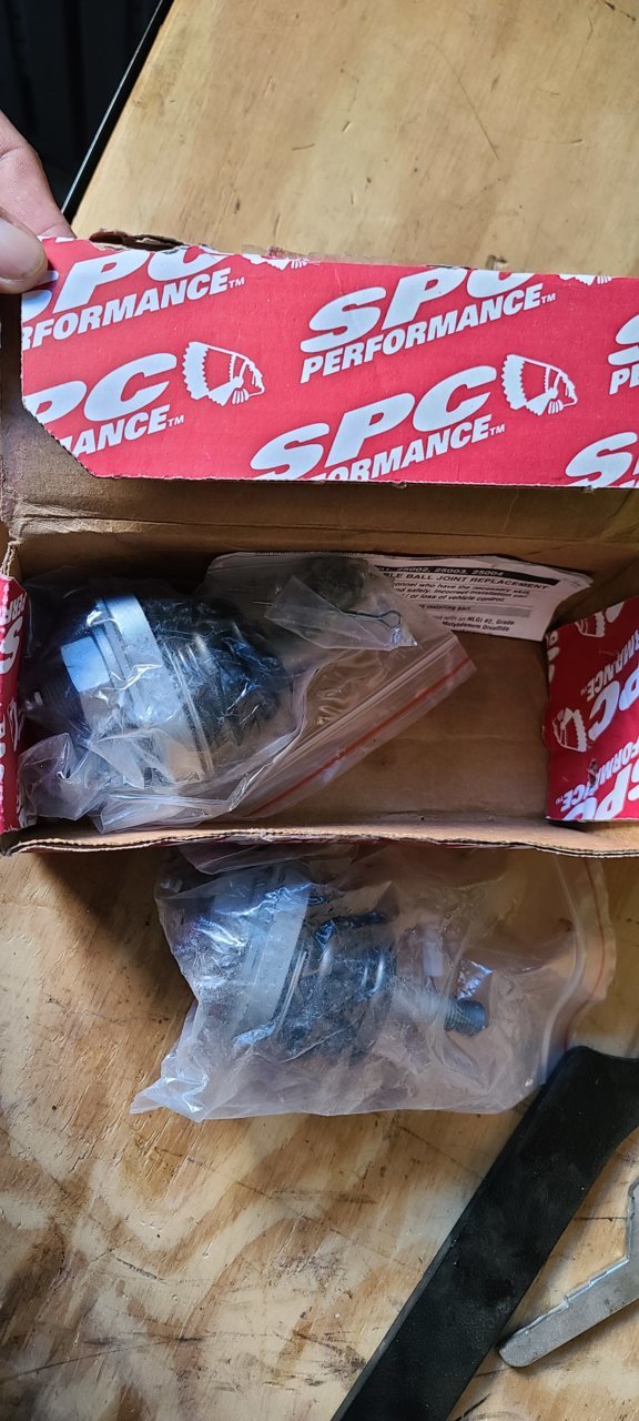

    I just bought a pair for backup and just rebuild the other one for back up. So I'll set the new one on D and push it out when I install it
