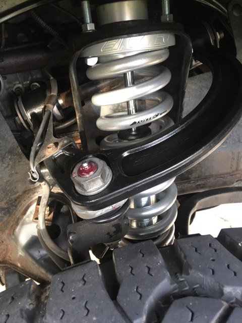

    looking at a used pair of SPC arms. Not many miles and in great shape. However I am. Not sure what Gen they are and I read the thread on this site about all the issues that had to be addressed on the first Gen’s. So my question is how do I tell if these have been upgraded or if they have the faulty stuff on them. They do have a Zerk for greasing the ball joint.

    Those look like the newest generation to me, with the forged arms

    Definitely not latest...thats a casting welded to tubing. Ball joint is the latest type though.

    that would be one generation from the latest. They come with the latest ball joint with zerk fittings, but still have the older specride bushings, and are still the tubular design.

    Nope they have always had half n half, only the latest gen is the fully cast/forged deisgn.

    This is the latest design.

    There have been at least 3 major generations of SPC arms.
    1st gen, half forged half tubed, non greaseable ball joint, BONDED RUBBER BUSHINGS
    2nd gen, half forged half tubed, non greaseable ball joint, SPEC RIDE FULL FLOATING BUSHINGS (to solve the "issue" of people installing the bonded bushings wrong - not at ride height)
    2.5 gen, same as 2nd gen, but with the zerk greaseable ball joint
    3rd gen, the latest, fully forged, zerk greaseable ball joint, with x-axis joints at the frame.
    You can definitely get the zerk greaseable ball joints and put them on any generation of SPC arm. DO NOTE: there is a part number for tacomas, and one for 4 runners as the taper on the ball joint shaft is slightly different.
    You cal also upgrade the 2.X gen spc (and maybe even the 1st gen) to the xaxis joints at the frame. But those joints are like 200+ bucks.
