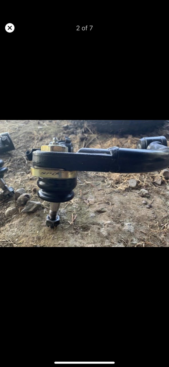

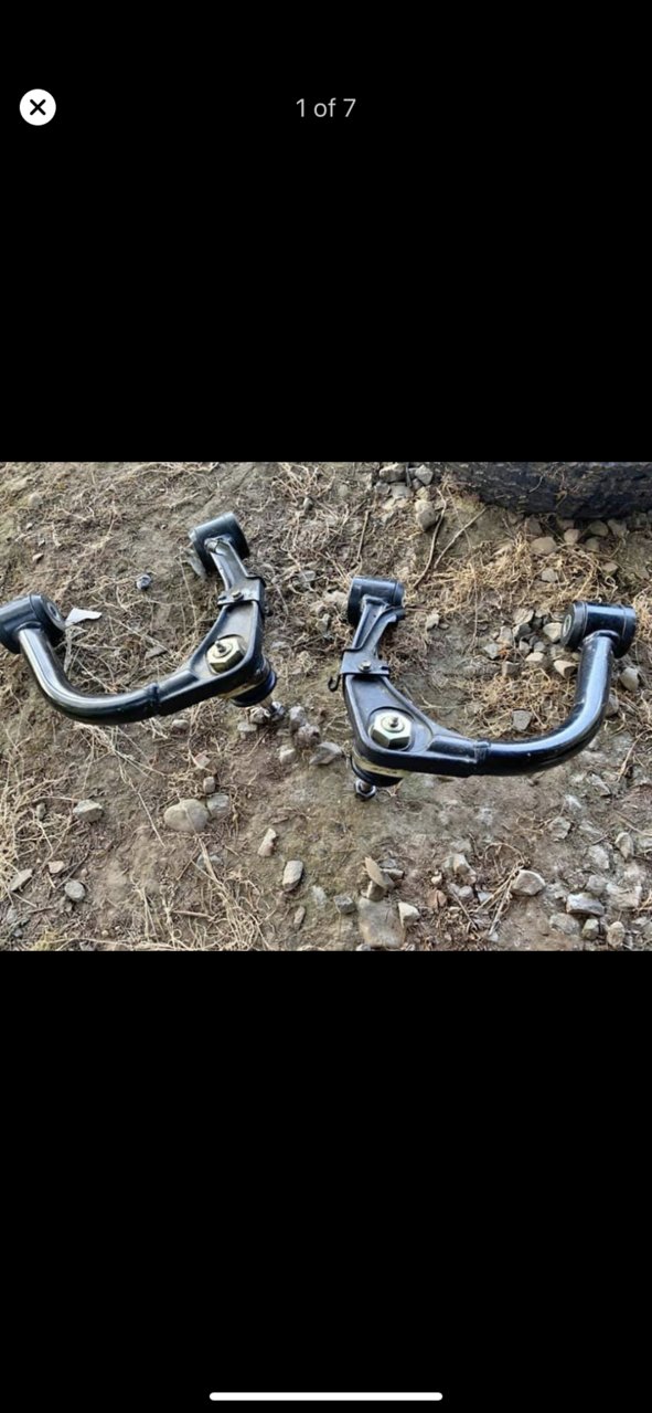

    Those are the second generation version it added the zerk fittings. The 3rd generation added the X axis bushings and the 4th generation added the one piece design. You can buy the X axis and new ball joints from toytec website anyway so if you want the one piece design thats the only thing really big difference that you cant upgrade on the previous gens.

    There was never a generation that had xaxis joints with half tube have forged.

    I've wondered that too but since SPC has made a few design changes to their arms over the years, I think these Mevotech ones are left over stock of the former design

    There was cause I have them!

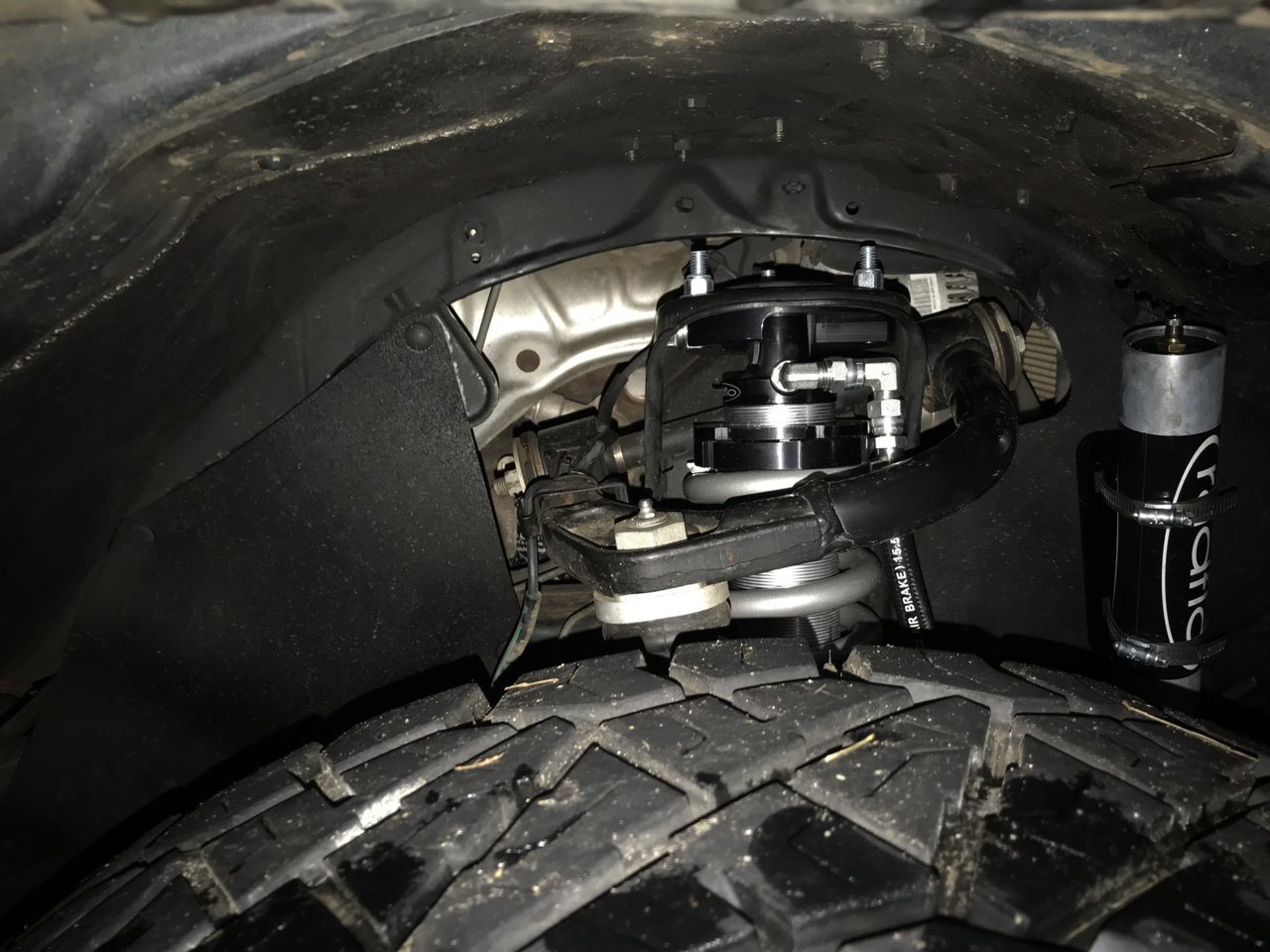

    Here’s a more recent pic

    Interesting! I stand corrected. That must of been a very short limited run before they switched to the fully forged (or yours were retrofitting with the xaxis joints)
    How long have you had those arms with those joints? any issues with the xaxis joints?

    Ive had them for about 15 months and got them Brand new.

    I got them literally right before the new design came out lol. Kinda made me mad.

    The Mevotech I received from rock auto are what I believe to be second gen . Has a zerk fitting , has the poly type bushings which I prefer as they can be tightened up in any position when installed without any preload on the bushings being the the arm moves freely up and down. I like them also as they hold the arm in place better than the softer Clevite bushings like the OE arms have. That translates to less steering correction as you drive being they are held in place with less unwanted movement .

    I see nothing different about the ball joint on mine and gen 3 , the instructions are SPC just like has been posted many times in the Light racing thread here on TC which is where you should be looking for all the info you could ever imagine on SPC arms. These are not a completely forged arm as the latest seem to be . these have the tube on one end of the arm which to the best of my knowledge with the zerk fitting on the BJ is the 2nd gen
