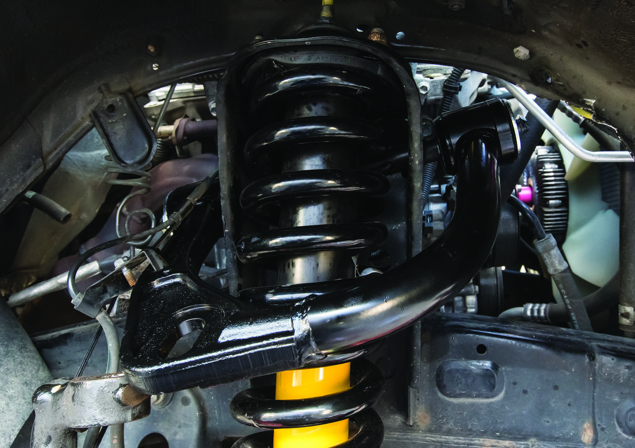

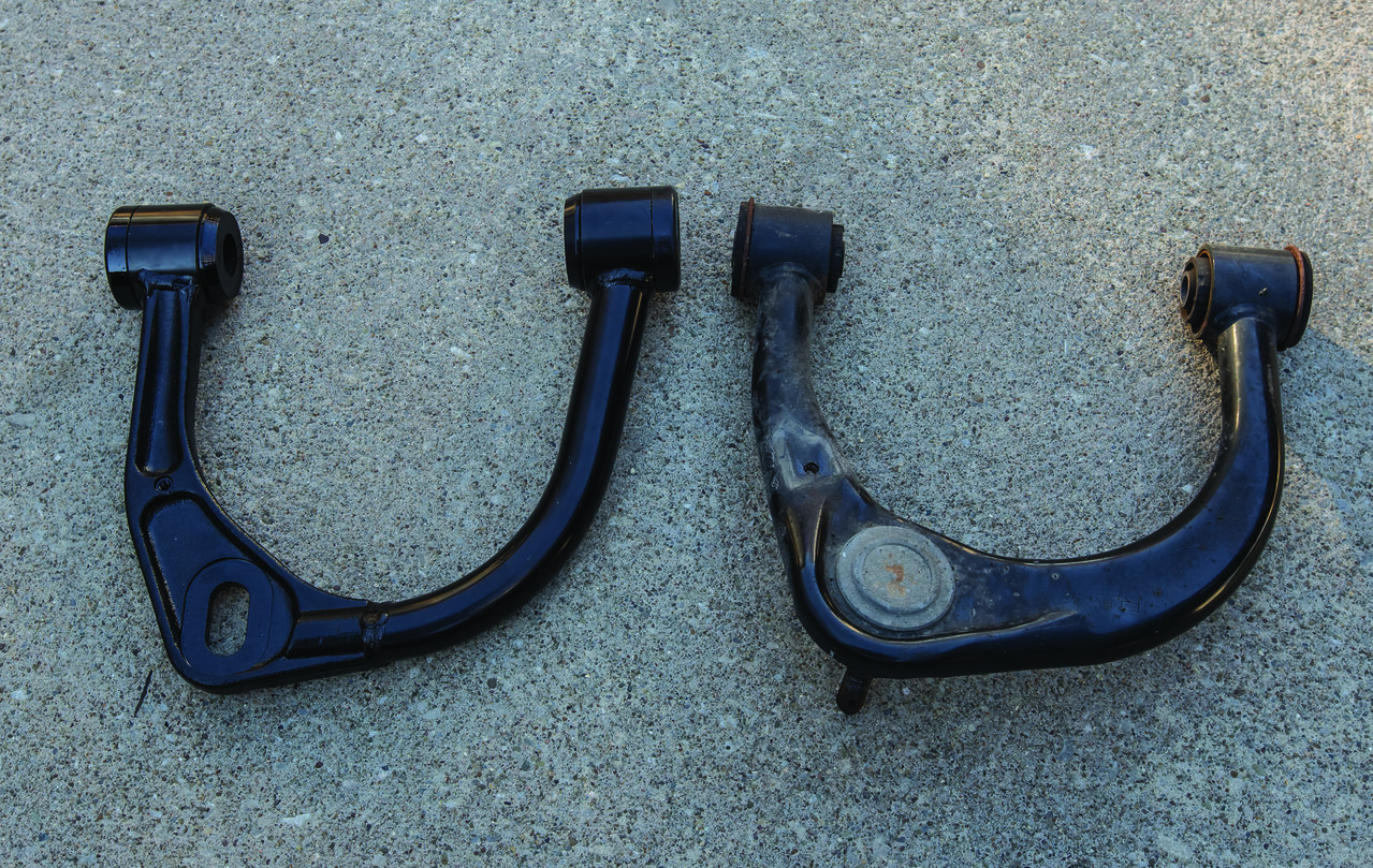

    Your inner bushing isnt the new spec ride, as it should be tapered. Check mine out in the below photos. Maybe that the problem?

    You're right. Mine don't taper like that.
    The reason I assumed they were spec ride is because they're clearly one piece and the inner surface that's against the metal sleeve has a checkered pattern in it and that's how I had heard the spec ride bushings described.
