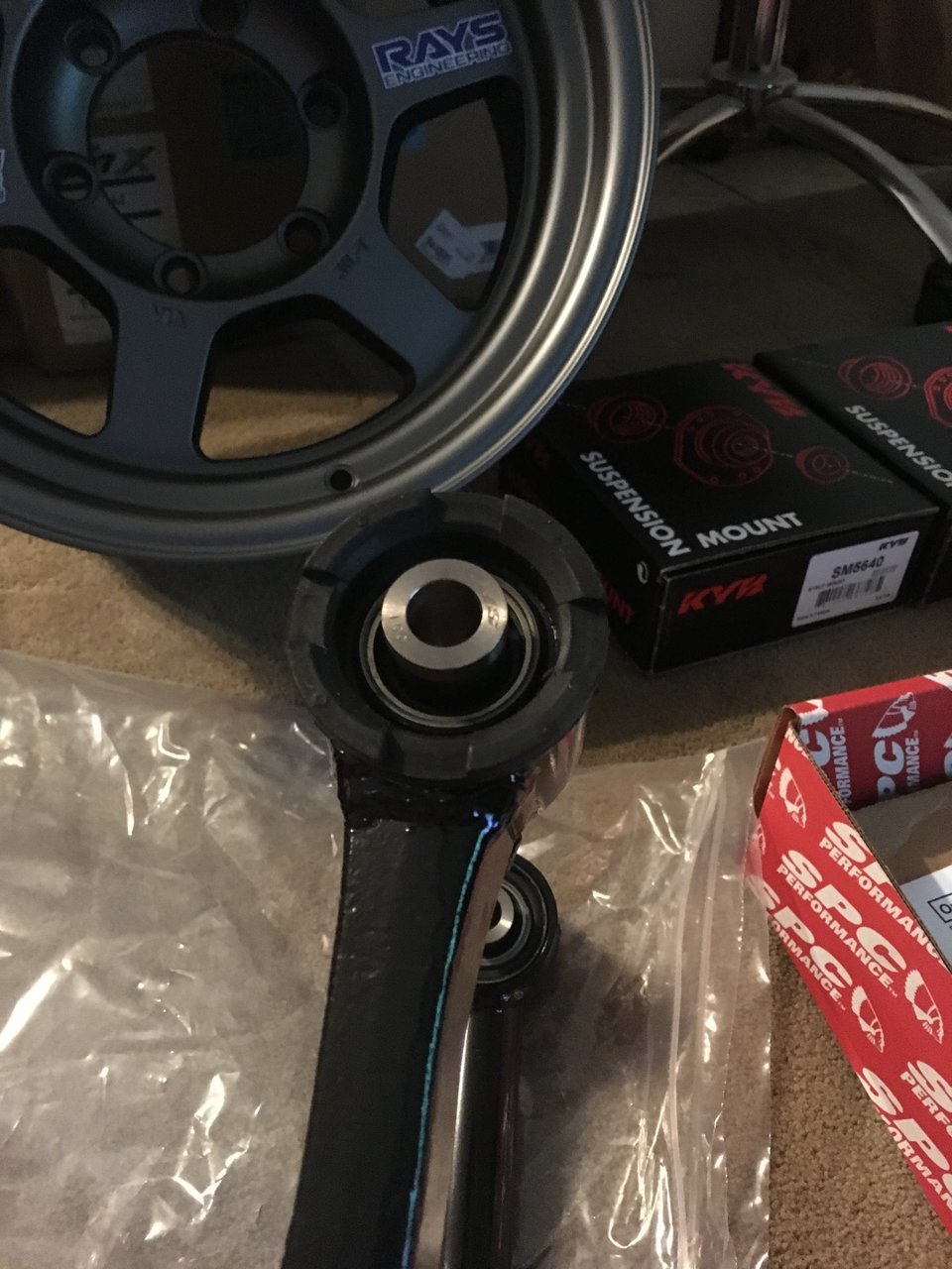

    I just received my set of SPC from @Babyjake16 from Battleborn Offroad - they arrived from SPC with this style of bushing- the most updated version I’ve heard.

    Which style? I posted 2

    X-Axis joints - greasable ball joint etc -

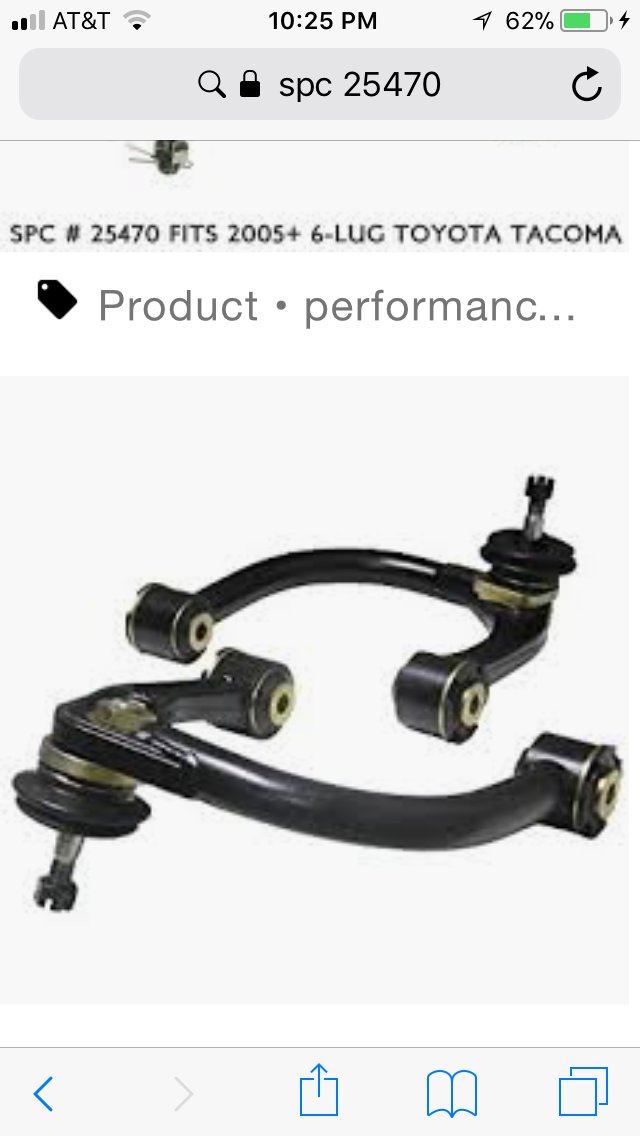

    I'll wait for in person pics of the bushings. The ones from Amazon and bilsteinlifts.com don't quite look like the ones on the thread here. They also say Specride bushing in the description.

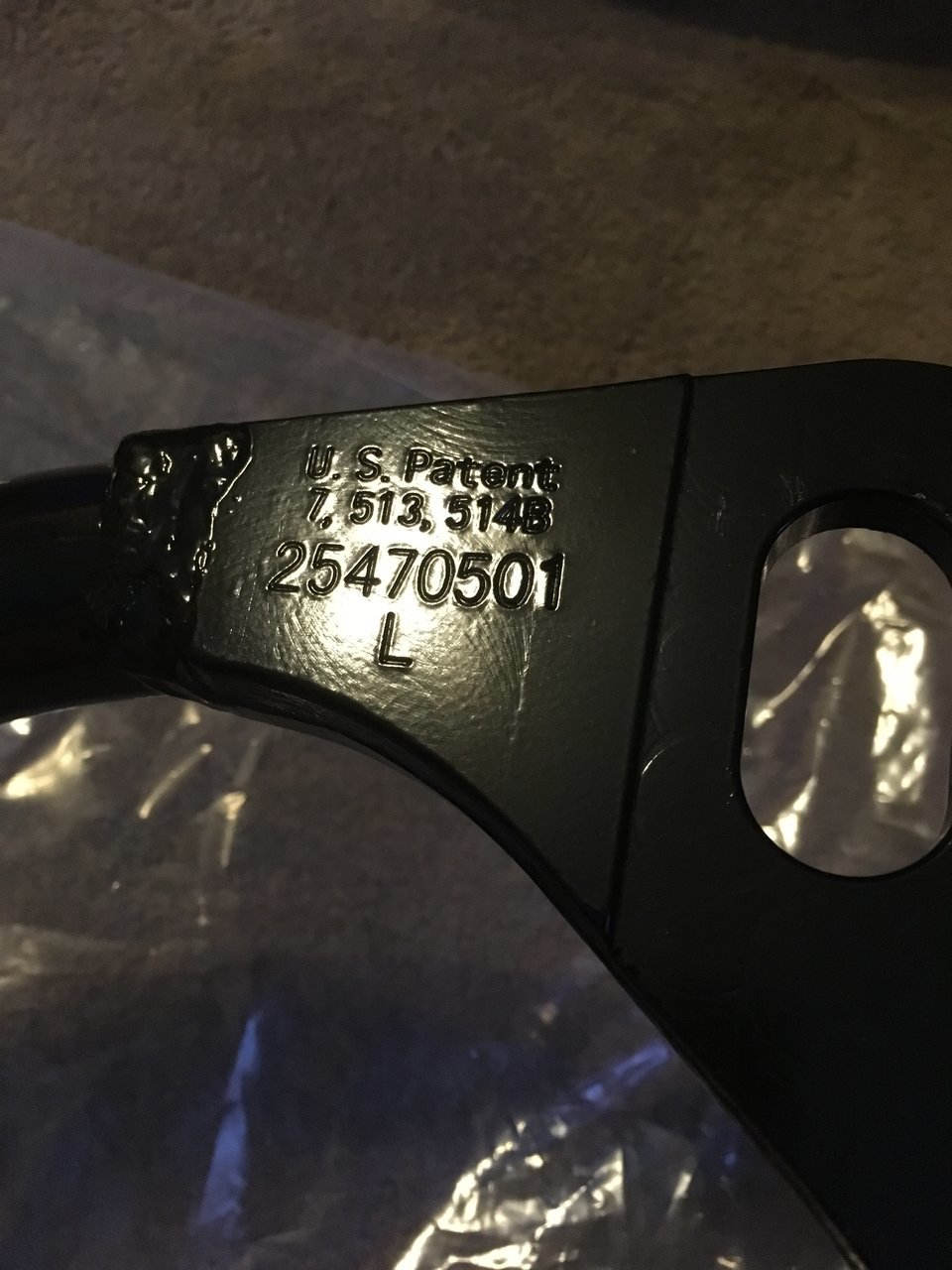

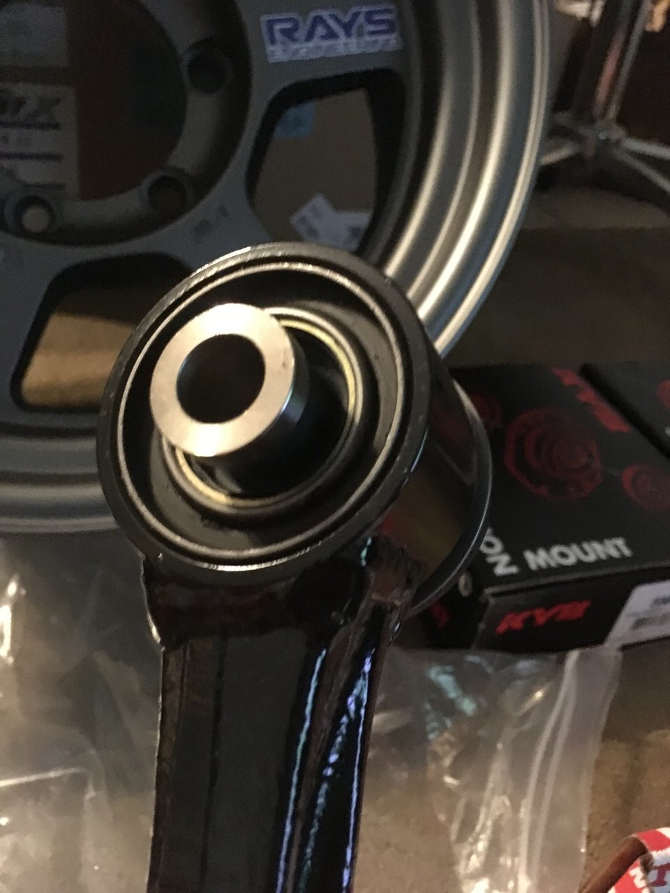

    @Sandman614 here are your pics, since you doubted me

    Sweet Ive asked SPC about these specifically. I never doubted you, just the company and seller you bought from.
    Do they have install instructions? SPC still links the old spec ride 2 washer install instructions.

    And those still look welded.
    I thought someone said something about cast.

    half, or one side of the arm is cast it looks like. Mine on both trucks are a tube welded to each side of the center piece.

    One side of the arm is cast the other side is a tube but they’re both welded where the bushings or pressed in
