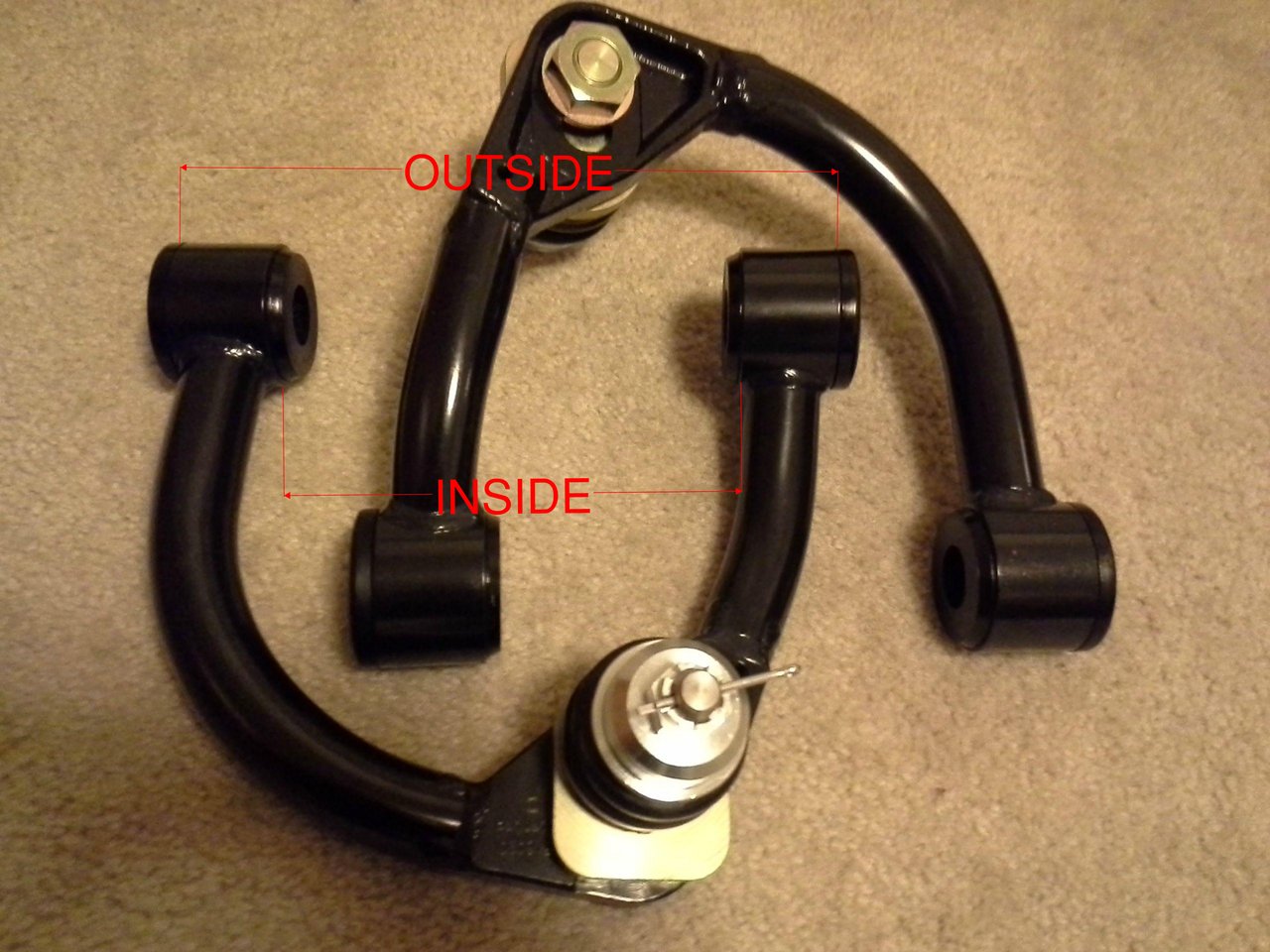

    For anyone interested in measuring, the outside measurement (disregarding the bushings) would be the critical one I think.
    The inside dimension should follow unless they ever changed the length of the mounting tubes.

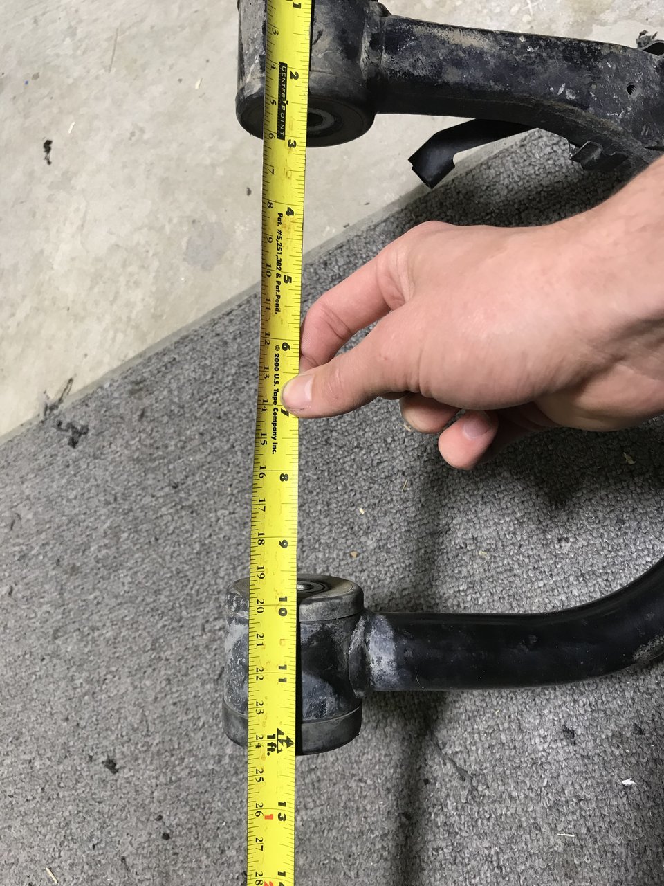

    What hasn't been modified?
    7 5/8 inside
    12 5/16 outsideDBE75298-FEC4-4B72-8D4F-8D6AC1E992FB.jpg
    This is the older style, the ones on my truck have the tapered inner bushing part. And I distinctly remember when tightening the bolt it squeezed the arm in just a bit

    It looks like you're including the bushings in your measurements?
    Just going by the picture... 8 1/4" inside (disregarding bushings)?
    Yea. It’s 8 1/4”

    And the outside? In case theres any difference in mounting tube lengths....
  13. Dec 4, 2017 at 11:14 AM
    #73
    YamaDirtrider
    YamaDirtrider Custom bumpers @FORT-ifyRigs
    Mar 1, 2016
    #179877
    6,343
    Josh
    Elizabeth CO
    06 DCLB sport postrunner
    11 1/4”

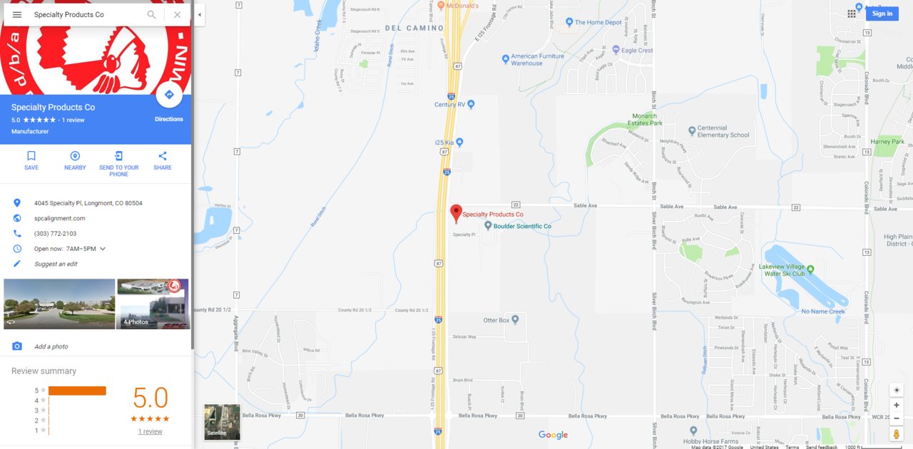

    I still think you should drive a couple blocks over there and see what they have to say... :boink:

    You and your ideas...o_O

    I always read they were very helpful to people with the old, shitty ball joints. Maybe they'll help you with with the bushings, being they're evidently a couple styles old.. :notsure:

    You guys are nuts! It's like 2.5 miles from my office. Google says it would take me 45 minutes to walk there!
