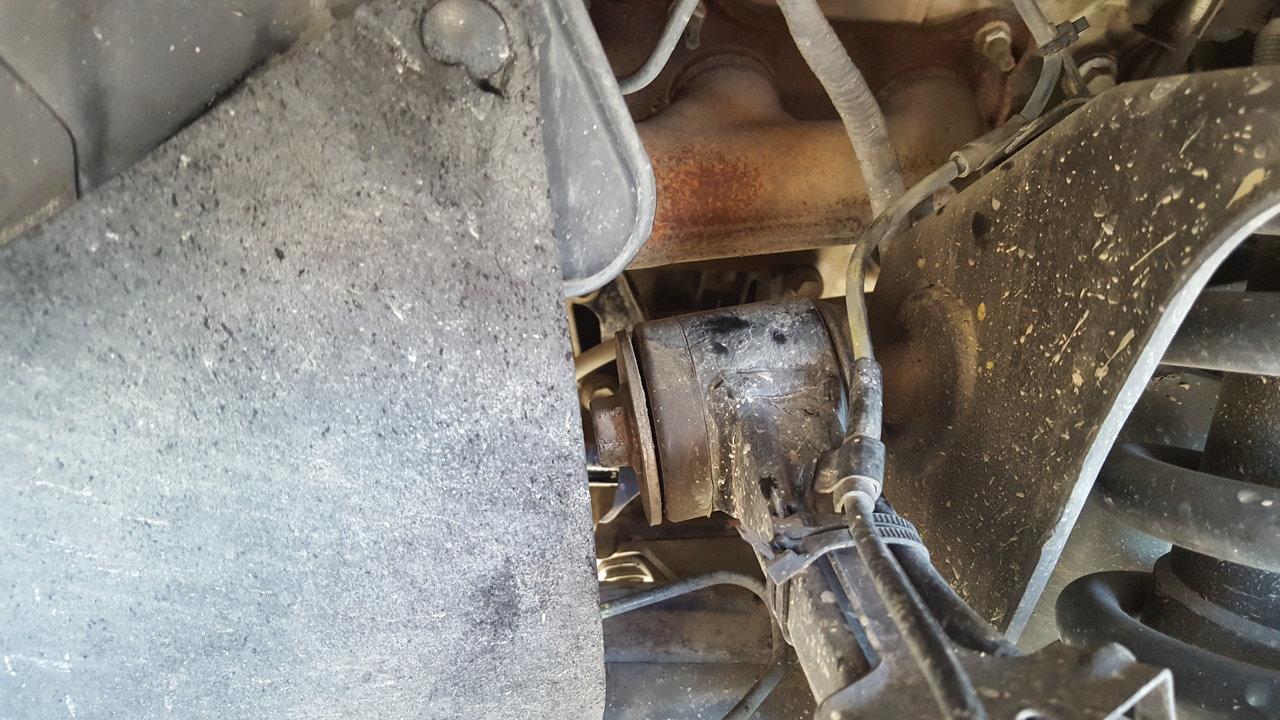

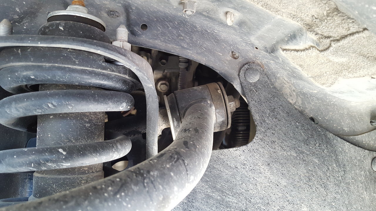

    added pictures of mine.
    you can see i used the washer on the inside of the bushing on only one side.

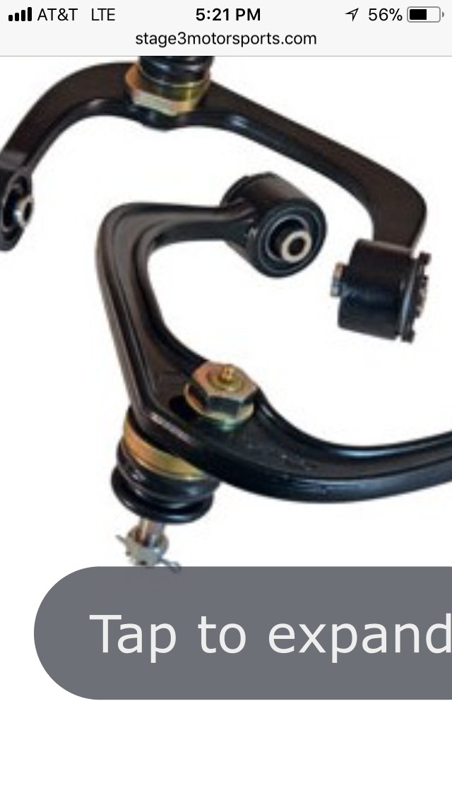

    These are the SPC forged uppers for a Ford F-150 - So I assume when they revise the Tacoma ones this is how they will look - i’m OK with the new ones I just received because they still look like aftermarket uppers

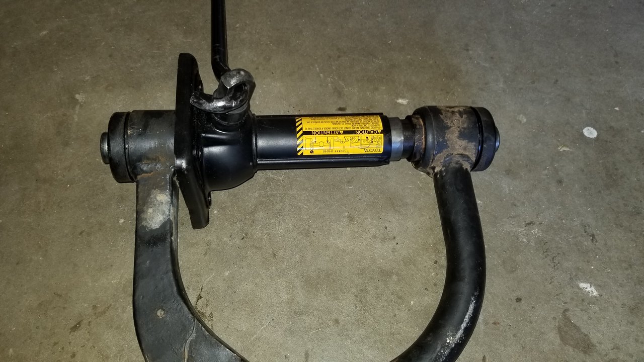

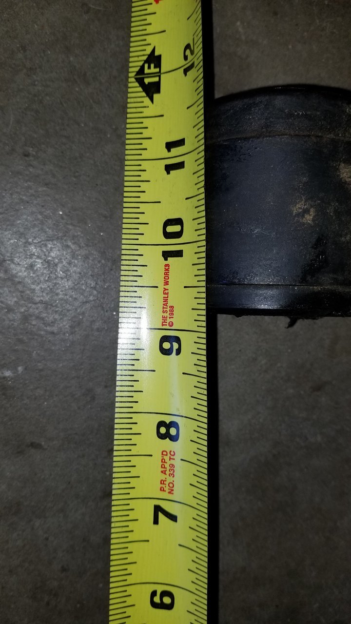

    Here's what I got from today. Using the all thread method to press out the old bushings stretched apart the arms about an inch or so. Measurements are immediately after removing from the truck.

    Yep...
    Just a BCH over 11" on the driver's side UCA.

    '12 DCSB TRD OR
    Factory bottle jack was a tight squeeze but worked perfect. Pushing them out just past 11.5 inches made them spring back to 11.25.1512849745465729502359.jpg
