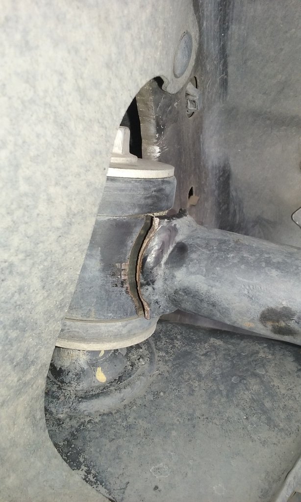

    I've had them installed for 3 years now. No issues up untill it broke last weekend. Even if they can't do anything about it I might still send it to them. It broke right on the outside edge of the welds on both the top and bottom. They need to put a gusset there like the icon tubular UCA's have

    This is the break. All around the weld. High stress area

    Are those the old style bushings / washers ?

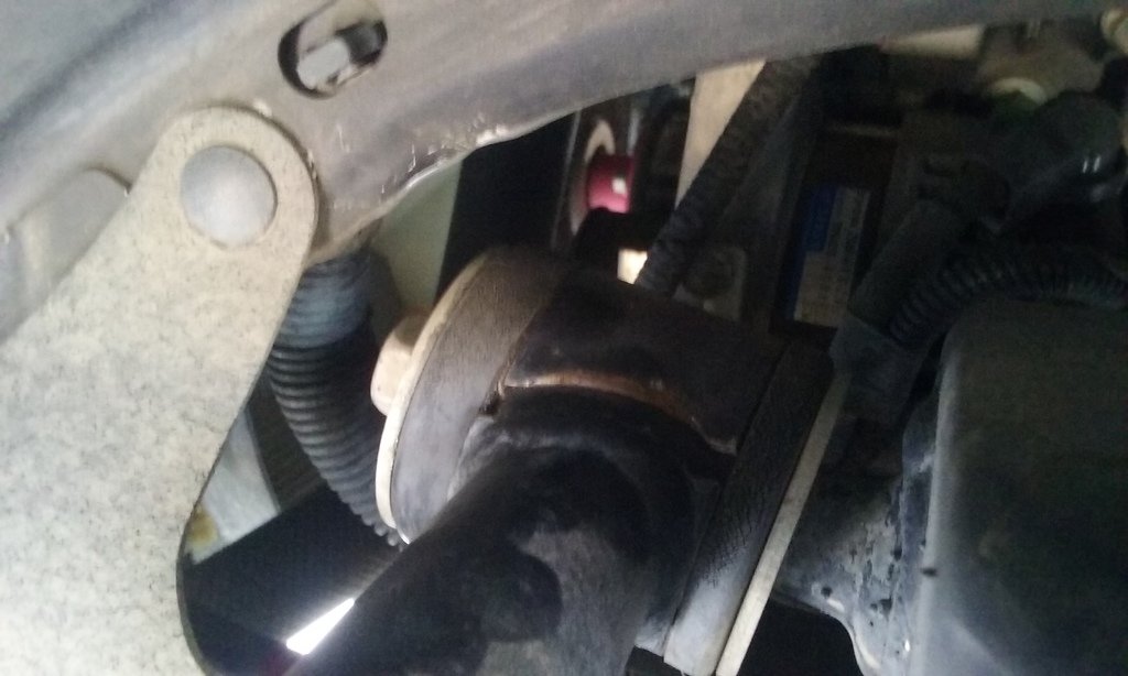

    The pics posted most recently with the washers on both sides of the arm are the old design. I was told by spc that this design pinched the arm too much and was causing the weld to snap. The most recent design has one washer on each end of the arm, this design should have 2 washers per arm not 4.

    Yep , the old style could allow for rotational forces to be transfered to the arms at the location shown in the pics above

    So I emailed the company last night and told them my issue with the broken UCA. They got back with me this morning and just asked for pictures. After I sent them the pictures they said its the old style with the 4 washers and that they are prone to binding so they will send me a new set. Great customer service! I don't go off-road often and for the 3 years that I had those I didn't have any issues up until it broke, so I'll continue to use them!

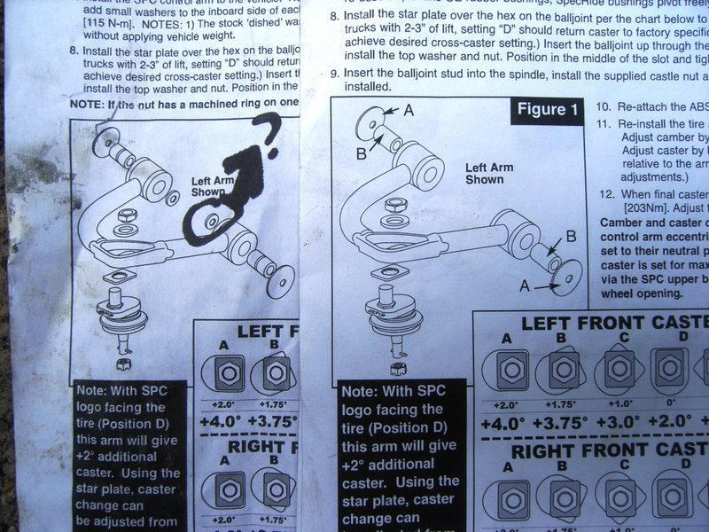

    Below is the older style with 4 washers VS the new one with 2.
