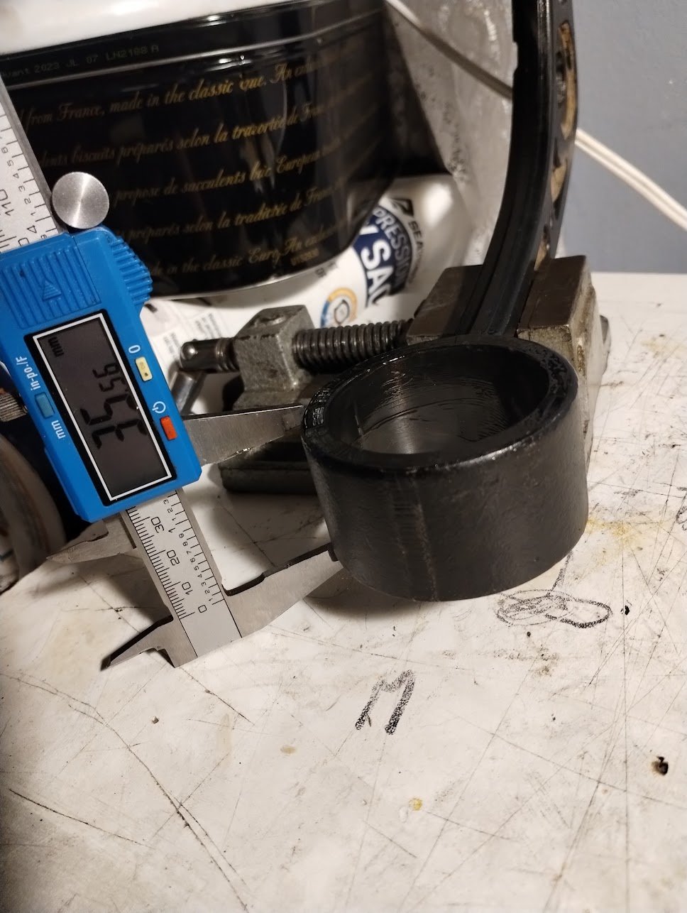

    OEM-sized UCA bushings don't fit SPC UCAs.
    Shveet and toku58[QUOTED] like this.

    Are the SPC's larger?
  6. Nov 30, 2023 at 11:42 AM

    Or Whiteline, or Energy Suspension...
    Kolter45 and toku58[QUOTED] like this.
