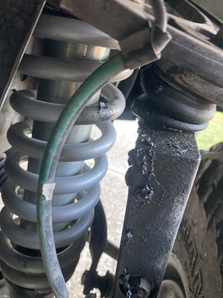

    Hello, seems my boot on my SPC uca has torn and now grease everywhere. Had good experiences with my 1st gen 40k plus miles no problem but on my 3rd gen with under 10k boot has already tore up. Anyway I’ve ordered new boots will I be good to drive a couple hundred miles before the new comes in? Thanks in advance y’all.

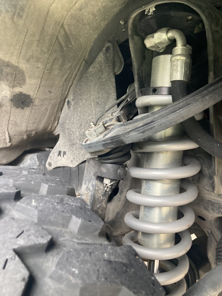

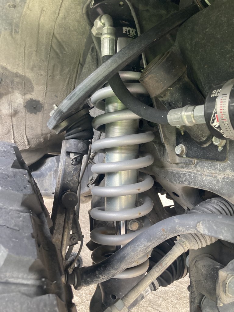

    Like 4x4junkie said, the RC droop stop bolted to the frame was designed for the stock UCA and does not work with upgrade UCAs. That's why the ball joint boot is touching the coil at full droop. You'll need to add limit straps.

    Some photos at full droop
