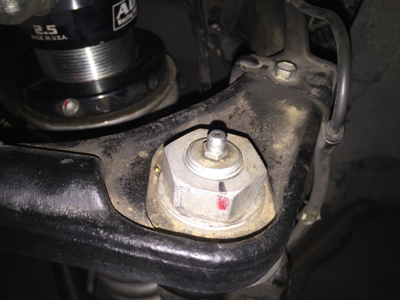

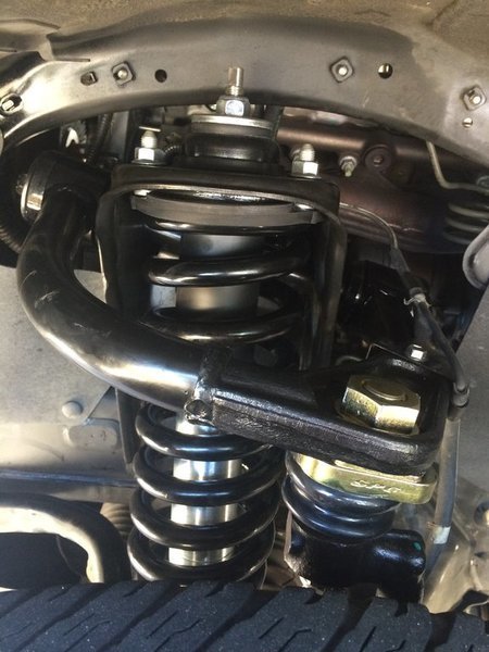

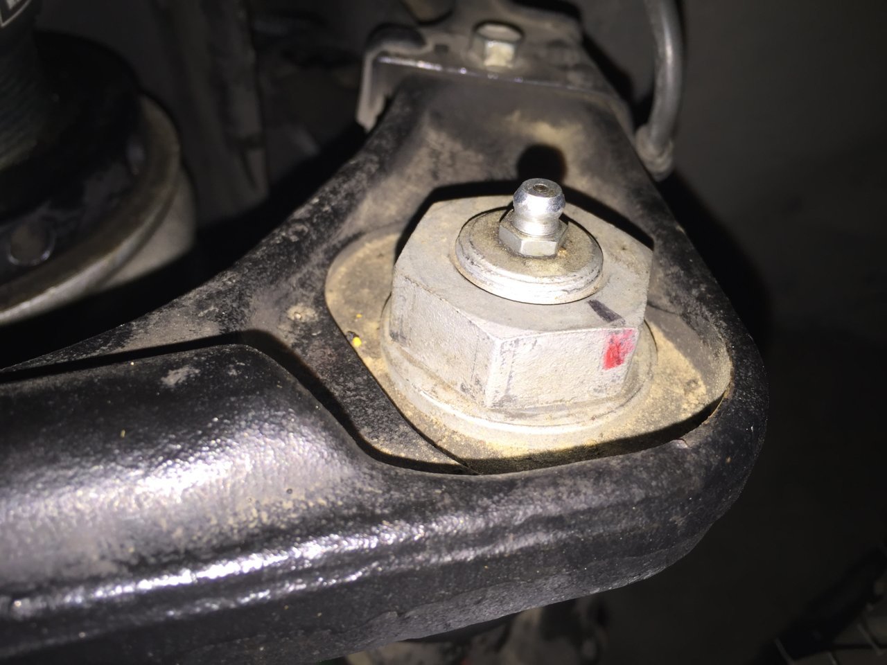

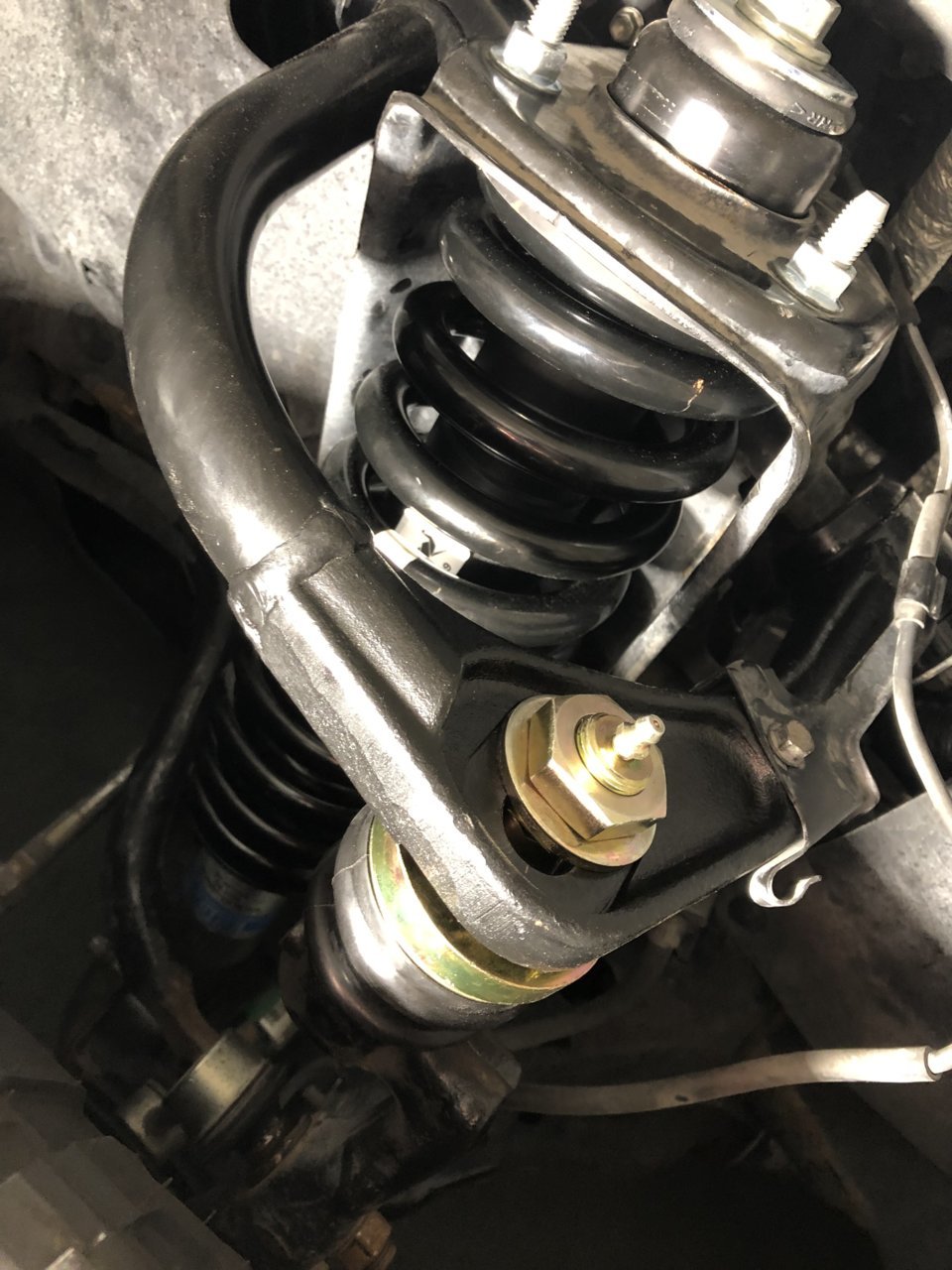

    So right off the bat, correct me if I’m wrong, but these are not slid towards the wheel as far as they should be. I’m assuming this is what he meant when he said he did this but it threw specs off. But some say it’s supposed to be “off” computer wise.

    Ok yeah...that could be the issue. Those are slid inwards toward the truck, they should be slid the other direction I think. That's why your camber is pointing your wheels inward I bet.

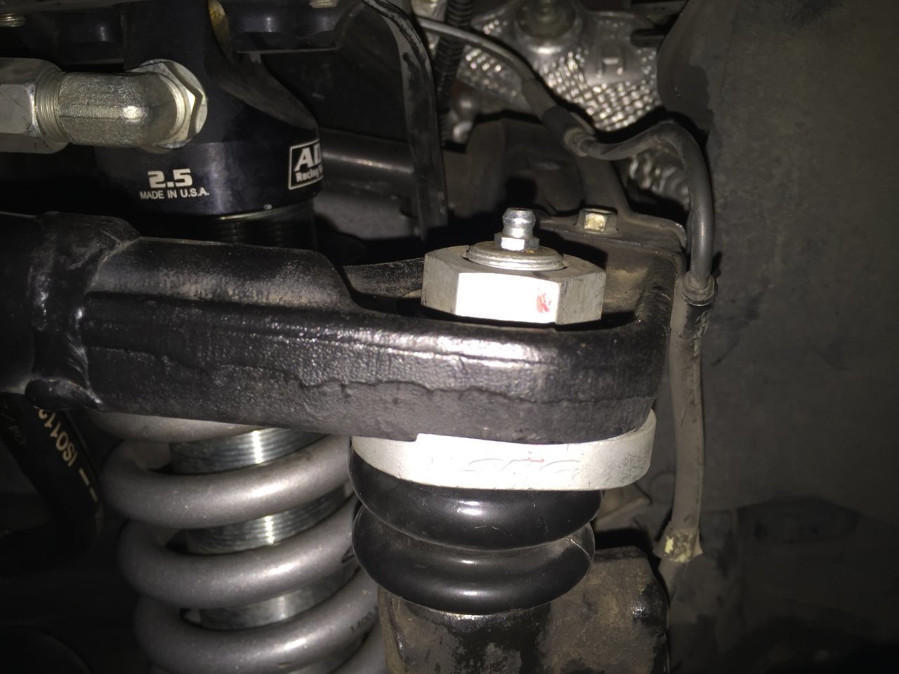

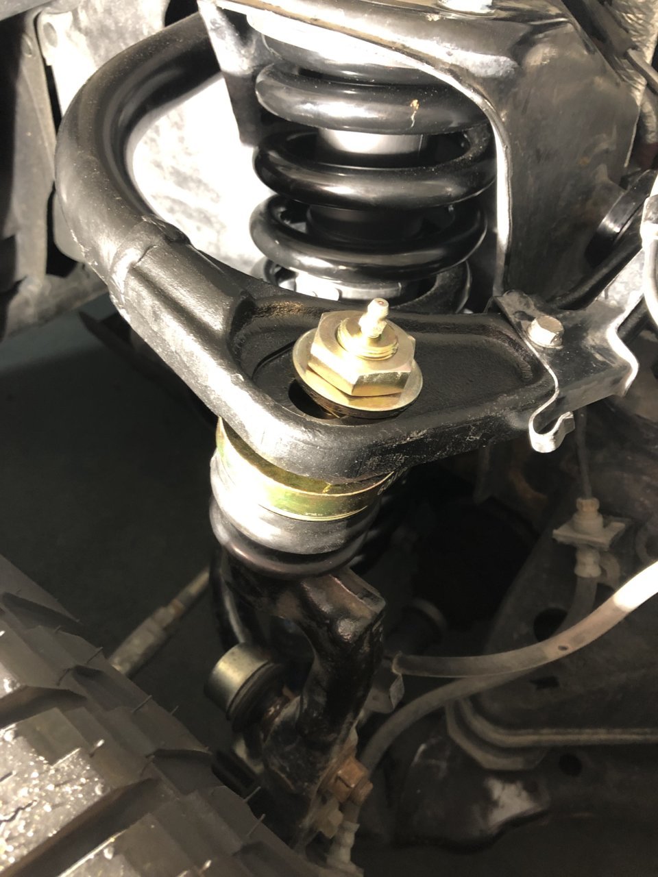

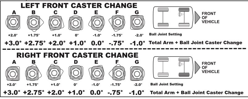

    Also that ball joint is not on the D/normal setting, I'm not sure which one it's on but when they are on the normal setting you can see the "SPC" logo facing you when looking at your wheels.
    Those should be adjusted to the normal setting and go from there, at least in my opinion

    This is one on the normal setting, you can see the SPC on the gold plate facing the tire

    69,391
    Azusa, CA
    Take my advice with a grain of salt but looking at those spec sheets compared to the photos you posted I feel like that's why you're having these issues, hopefully someone else with a 3rd gen and SPCs can chime in.
    If they have the instructions for the SPCs then they should have that spec sheet for the ball joint, but I'd bring a copy with you just in case

    But that could explain why they had trouble installing them at the right setting, without that sheet handy with the ball joint specs they wouldn't know which setting to put them on.

    I gave them the sheet. I got one for that reason. I think they just misunderstood parts of it. Bc they looked at it and said yea we have it matches to how it should be. Guess not. It’s a great group of guys. They’ve done tons of Tacomas here. But first spc they’ve ever worked with

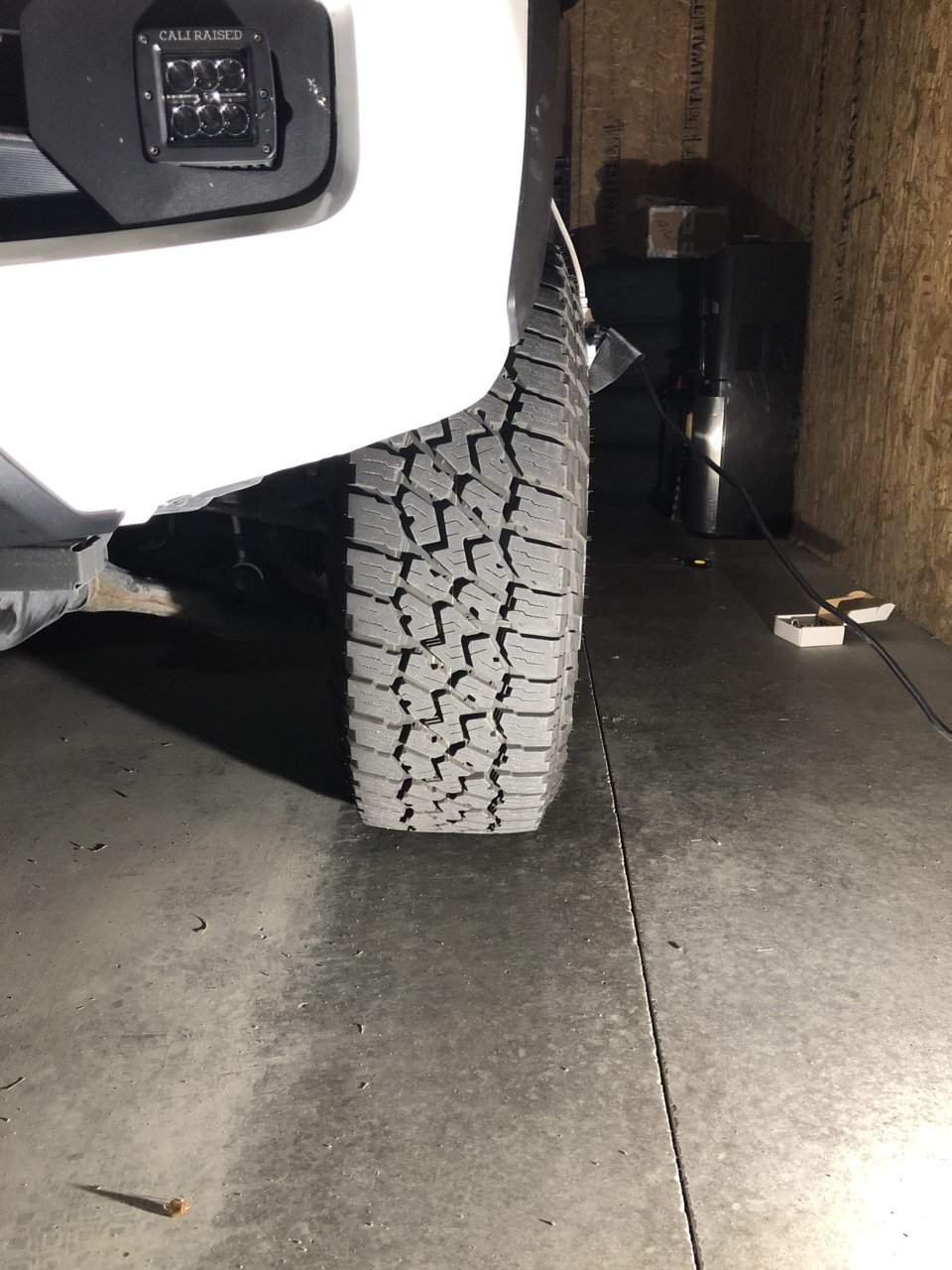

    Here’s current status

    That doesn't look too bad really but it's hard to tell via photos with camera angles and what not. But at least it isn't crazy bad lol.
    The good news is (from what I can tell anyway) is that once you get the SPCs put on the normal setting you should be good. Heck you can even do it yourself if you have a floor jack and hand tools + torque wrench, but you'll still want to get an alignment done afterward
    All you gotta do to adjust the ball joint is loosen that top nut with the front end off the ground, then turn it by hand and retorque to 150ft/lbs when you're done. But since the shop did the install and alignment I can understand wanting to have them do it.
