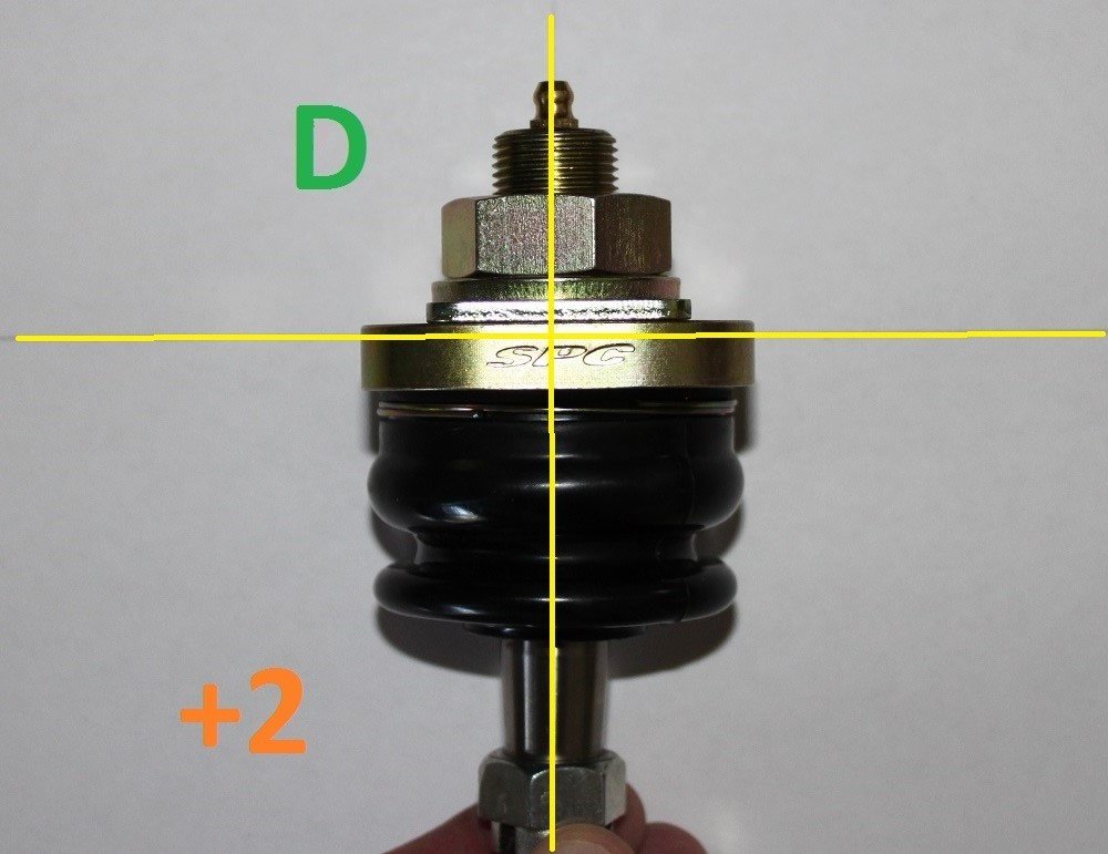

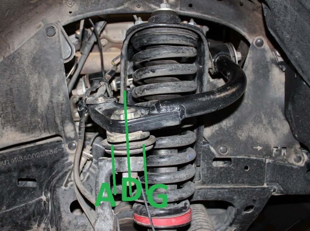

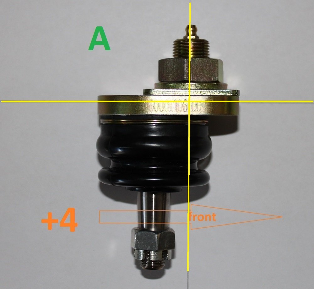

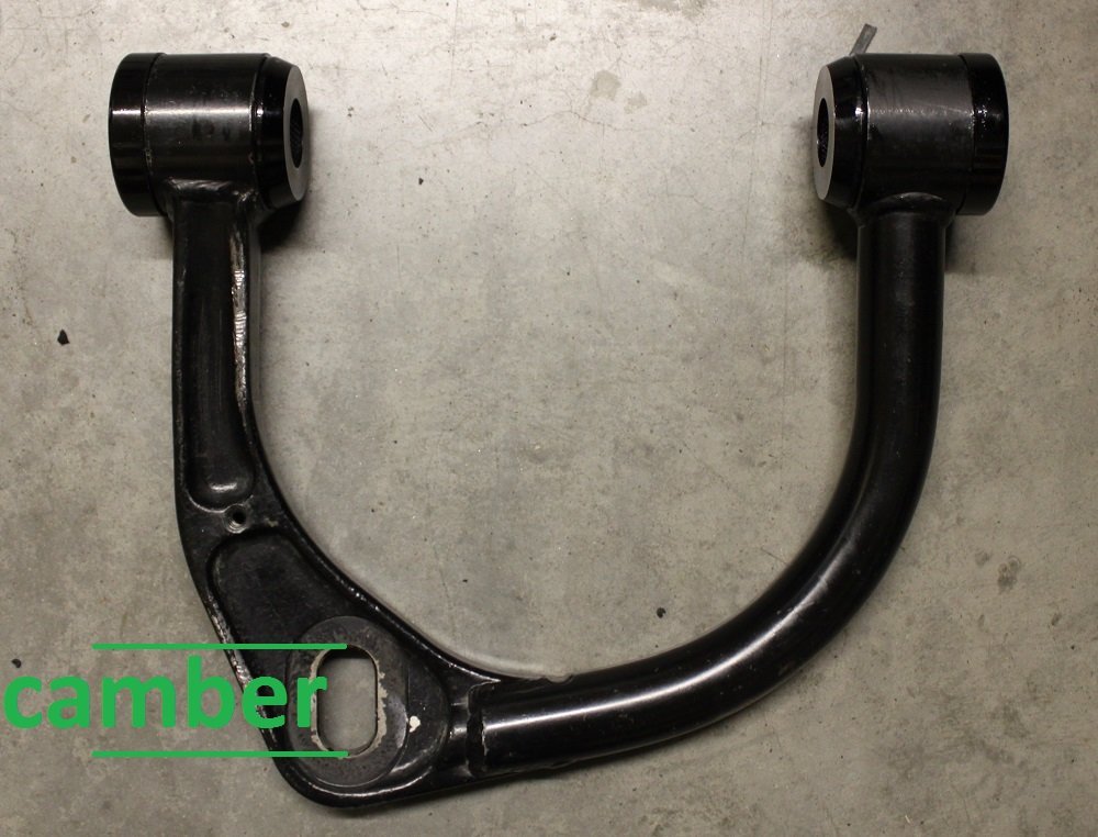

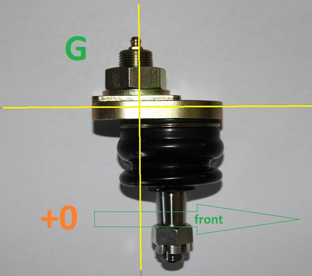

    Just to add to this.
    4th pic is what is old style arm with "newer" spec-ride bushings...edit for wording. Guess i thought i was in a different, help identify thread...Doh.
    Last pic has the original bushings.
    Couple pics for future reference.
