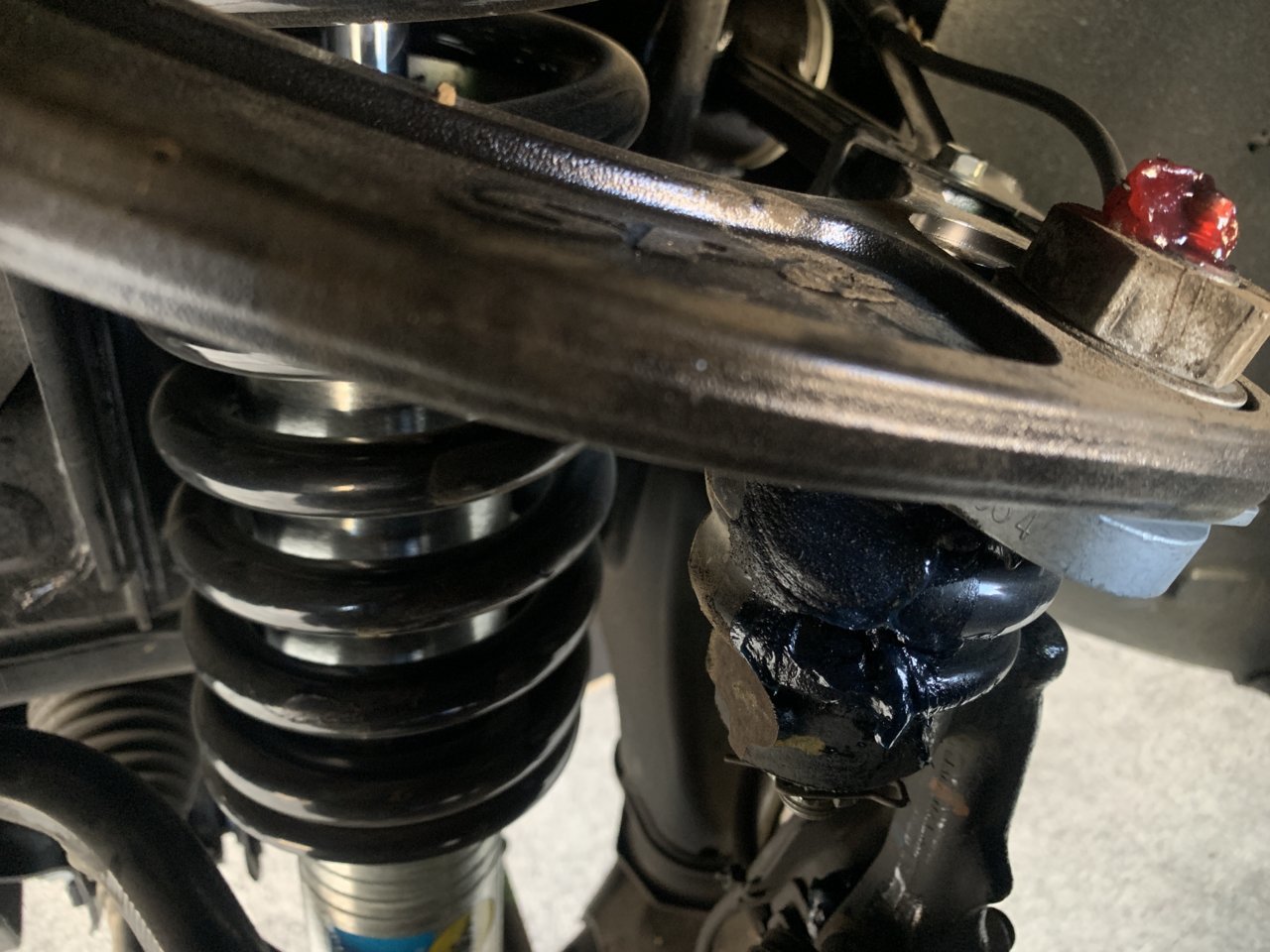

    This is not normal is it?

    Yes it is. If you put new grease in, the old grease has to go somewhere, it doesn't just disappear. I've had SPCs for almost 3 years and grease them every oil change as suggested in the instructions, the old grease comes out the bottom (usually after driving around a bit) and gets wiped off.
    No issues with mine, still on the original ball joints they came with and they see a lot of action.
    Edit - the fact that the grease is coming out the top tells me that those are over greased...should only need a few pumps per side with the grease gun. I would wipe those boots down and make sure there's no cracks or tears...the old grease should really only come out the bottom of the boot. Over greasing them can cause problems

    Too much grease.

    Thank you these were just put on same time as wheels and tires and lift. 2days later I went off-roading. Probably greased out when I first tried at full flex

    Looks like the boot is torn. You'll find out when you wipe the grease off.

    Minimag95
    Minimag95 Well-Known Member
    Nov 8, 2017
    #235456
    1,655
    Niles
    Annapolis, MD
    2009 Pyrite Mica V6 SR5 4x4
    OME's w/ 887 Coils, SPC UCA's, 285 ST Maxx. Mobtown sliders & skid
    Wipe the grease off and check that the top of the boot is intact. I believe there is a metal clip/ ring that holds the boot on the top. If it was overfilled with grease its possible that the ring popped off causing the boot to seperate from the top of the ball joint
