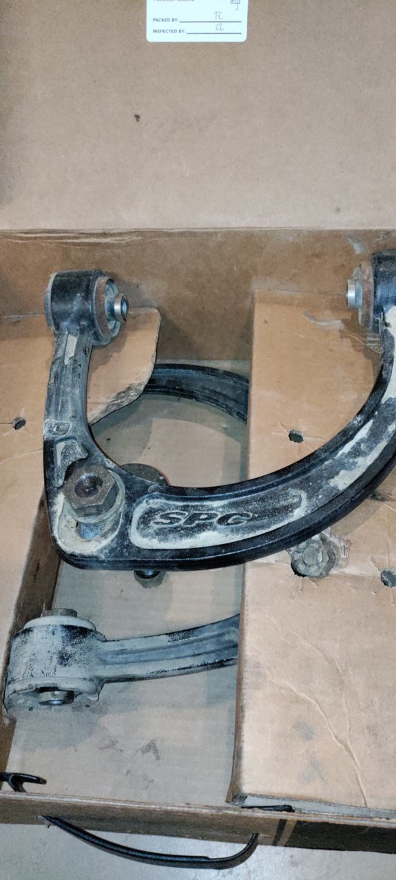

    I recently was given a set of spc ucas, they guy gave them to me because he had the same problem with them blowing out 2 or 3 times within a year. And I'm just wondering if it is even worth buying a rebuild kit and installing them? And if so is there a updated link for the rebuild kits that are also in stock?

    Side loading the crap out of the lower arms for tire clearance is definitely NOT the right way to do it, it’s probably the worst way.

    they are complete junk. I wouldn’t give those to my worst enemy. Between them and the cam hardware that company doesn’t impress me in the least.
