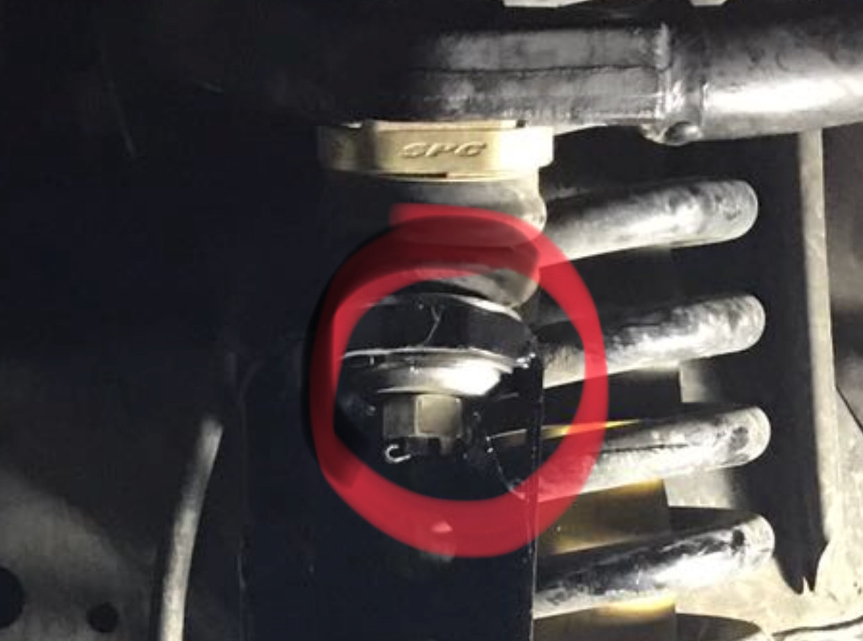

    Recently swapped my steering knuckle insert to a new spindle with a total chaos gusset.
    Issue is the aluminum insert did not get the interference fit nessesary and rotates while trying to torque the castle nut to 45ft lbs
    I called SPC talked to R & D about the issue and confirmed the insert should not rotate

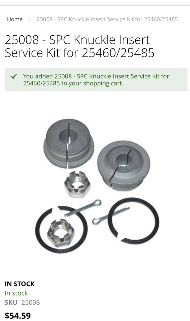

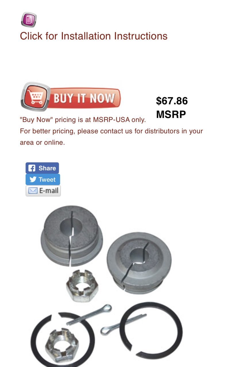

    Solution: 03E36ACB-7CF4-4E75-9508-3F4AC9563B88.jpg
    SPC said to go through Toytec for a lower price
    The new adapter will expand when tightening, got next day shipping. Will update as parts arrive

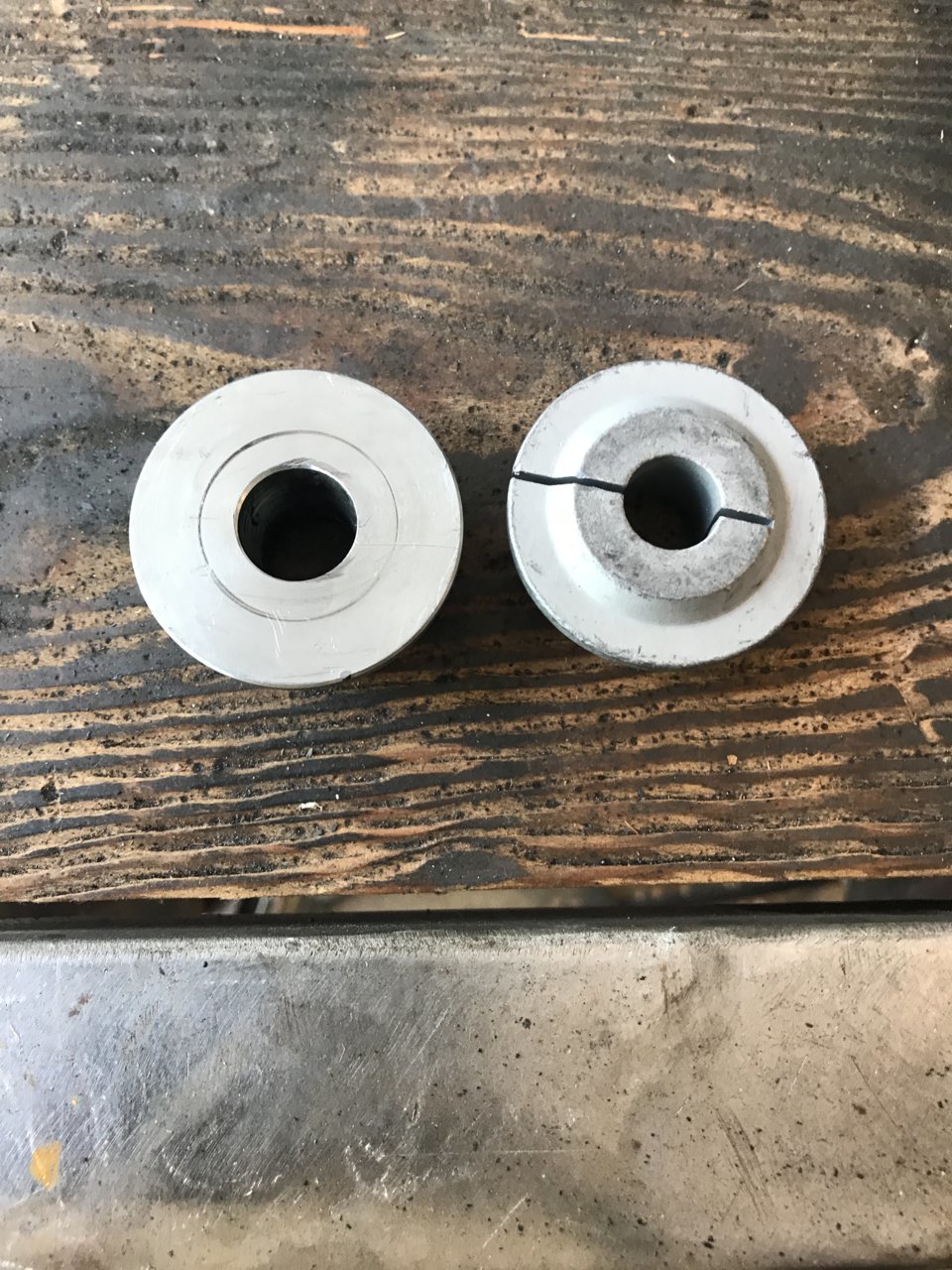

    C038F9B2-AE37-4BB9-BE5A-2E4EE0CD31C3.jpg 1D096C40-BCFC-4731-9010-6B10735D87D9.jpg
    Here’s a comparison, install was straightforward. I was able to torque to 45 ft lbs and no spinning.
