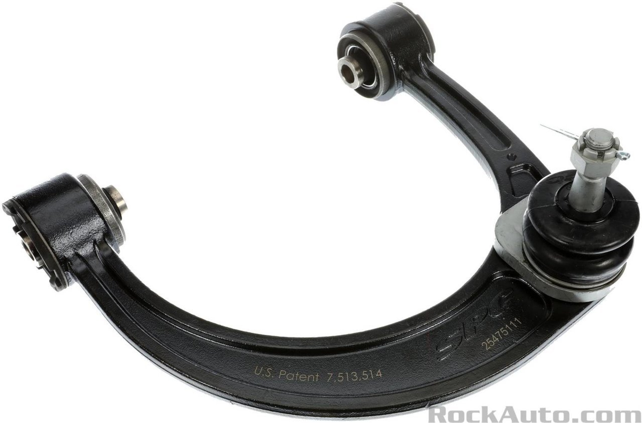

    Sounds like SPC takes their old stock, gives them to other brands to resell.
    Both of those links show the last gen greaseable ball joint that has now been replaced with a non greaseable one.
    Also like how the ball joint is oriented the wrong way in those pics haha
